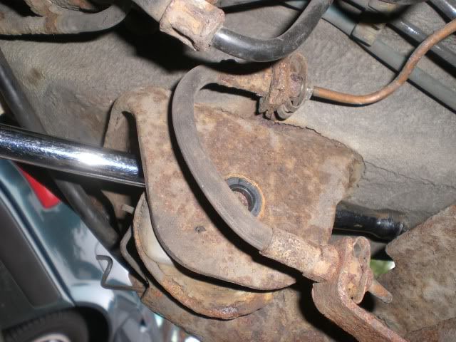

I'm going to try my luck and do it in situ - before resorting  to removing the beam entirely.
I've got MK4 rear callipers - so they are upside down, making bleeding them a total arse, not to mention I changed the fluid around 6 months ago anyway.
If I fail totally, I can still remove the beam and do it, I don't mind spending a couple of hours trying at least.
I'm going to find some chunky threaded bar :)

I've got a pre-88, so the handbrake cables only reach with the callipers upside down and left to right ... and you can't bleed callipers with the nipples on top, so they have to be removed and chocked.
After asking for advice, I've ignored all of you and bought some cheap Poly Sport bushes :D If they are harsh/twitchy, its only £30 and will be very easy to remove and fit. Next up, my front top mounts ...

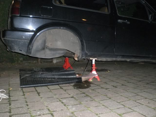

I think you're a fool not removing the rear beam.  It's going to make the job about three times as annoying and tiresome as it would be otherwise.  Bleeding brakes isn't exactly a huge chore on a G2.
There wasn't even much point bothering in the end, as I couldn't actually see it even being possible due to the short length of the rubber brake hose.
So it ended up looking like this ... :cry:
It wasn't too difficult a job, took about 5 hours all in - but I did make it difficult for myself by not removing the rear shocks before removing the beam! I did a bit of a write-up in my dub project here http://www.golfgtiforum.co.uk/index.php?topic=49436.msg1520093#msg1520093

Nice one Ben, you did make life harder for yourself, by not dropping the suspension first.
It must have been a pig to get it at the right angle to get them back in?  :laugh:
