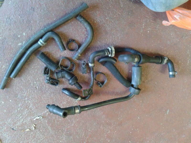

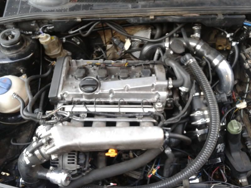

I'll start off with the pics from last time of the brake booster junk that I pulled out, and how the engine bay looks atm. battery is missing in the pic as I was trial fitting it in the boot
hard to believe that took me the best part of a day to do  :grin: looking at that it still looks a mess, I got my work cut out sorting all this out

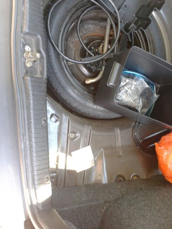

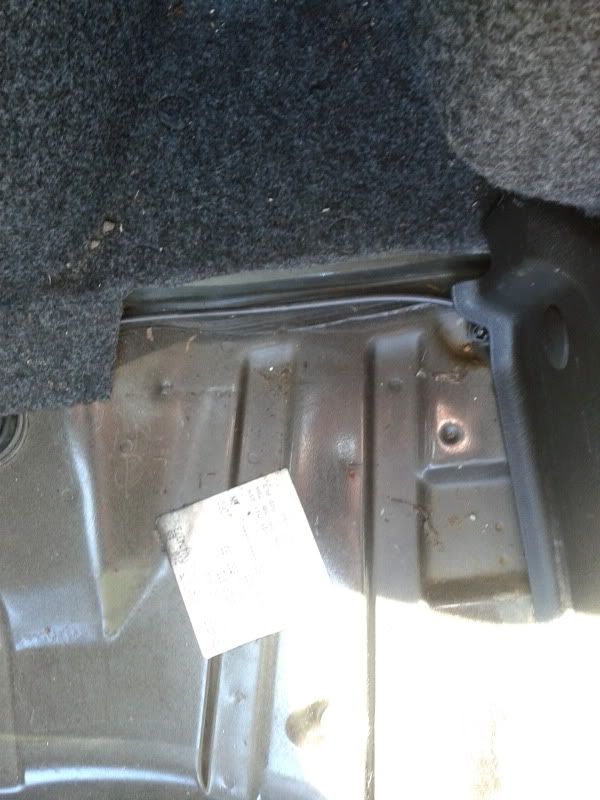

so now what I did today. Started by taking the boot carpet out and making some space, and seeing where I could fit the box. I wanted it on the passenger side but as the spare wheel was in the way I decided to put it in the drivers side corner. In case you dont know where that is heres a pic  :tongue: dunno why its sideways  :huh:
Cut away a piece of the carpet so it can sit flush

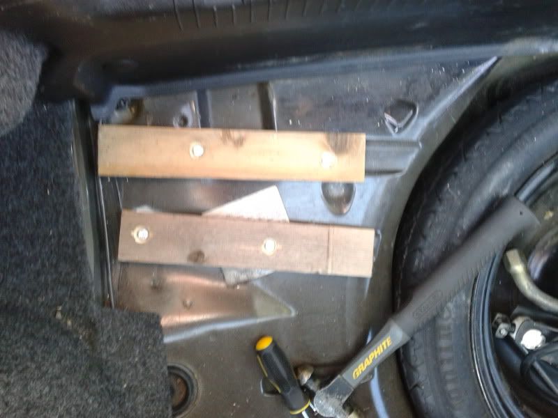

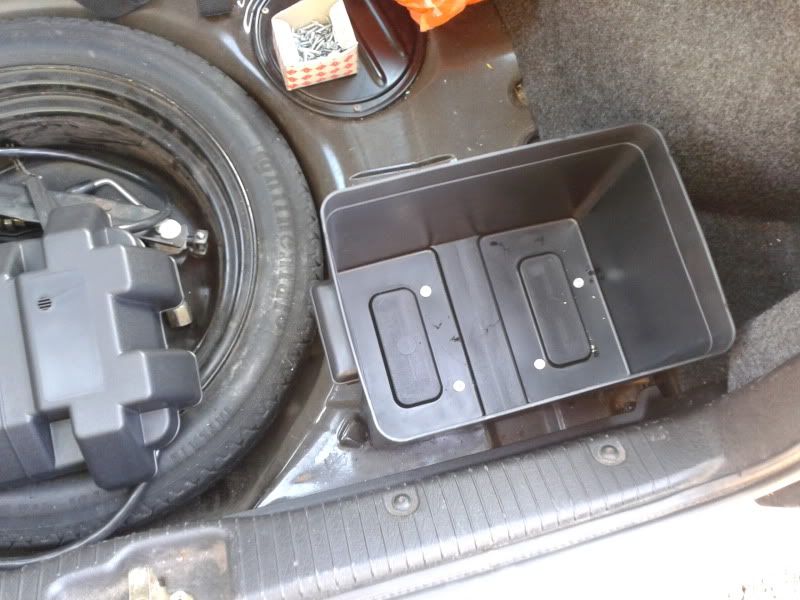

I trial fitted the box at this point and decided against fitting it directly to the floor, so I went on the hunt for some wood to sit it on. Few minuites later I emerged from the garden shed victorious! Drilled 4 holes and fitted them to the floor as follows ( I need to polish my photo taking skills, somehow managed to get one upside down)

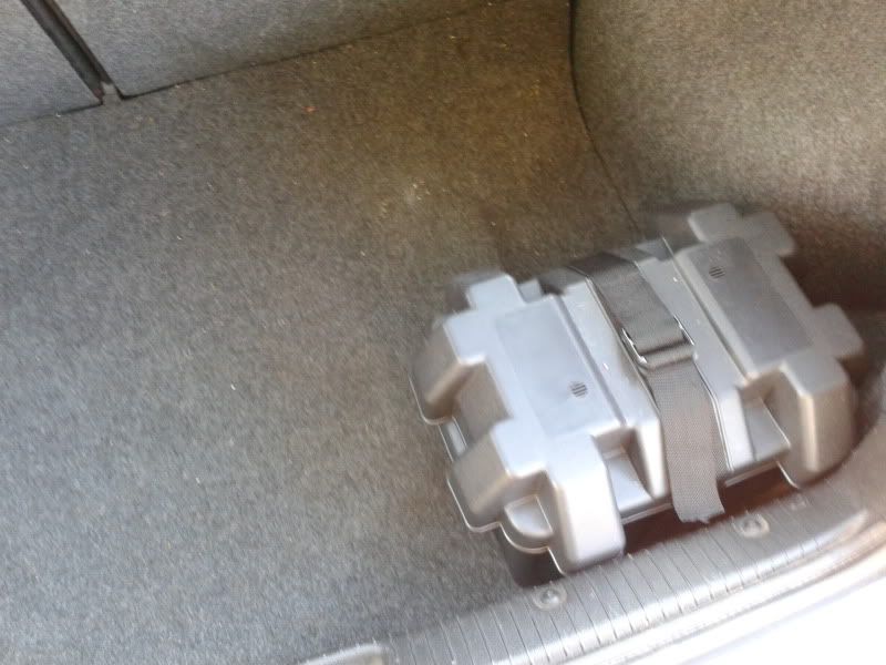

next up was the boot carpet, no pics of the process bit I basically cut out the shape of the box, leaving about half inch to an inch to fit underneith the box making it level with the wood and also making the fit look nice with no raggedy bits of cut carpet showing
and thats what I did today, looks pretty good if I do say so myself  :smug:

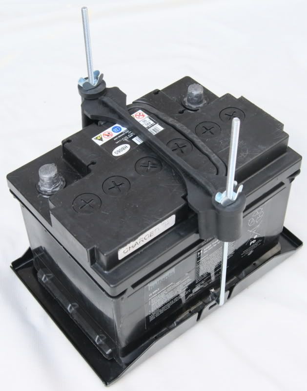

It was £7.99 from a company called ZoomerRoo. cheap as chips  :grin: its only made of impact resistant polypropylene though it needs a tray or something in there to hold the battery in place, there around 1 or 2 cm gap each side with the battery in there
My tray wont fit even if I cut it down due to how it hold it in place so I'll probably be buying a custom tray, something like ths costs £19.99 from the same company. should fit perfectly inside the box just need to measure it up
In the meantime I'll run all the cables etc so all I'll need to do is bolt in the tray and fit the battery
