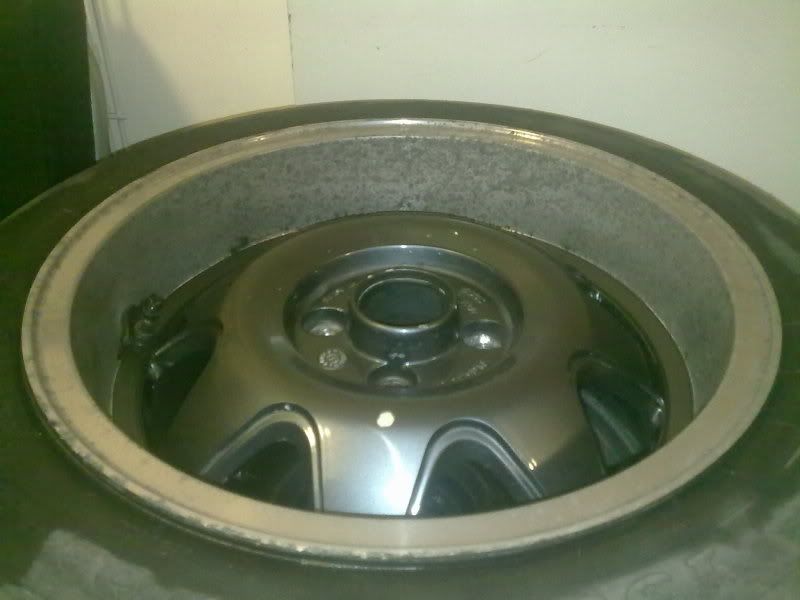

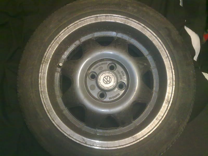

But i've been after some wheels for a while and a friend decided to sell his MiM cups(exactly the same as ATS cups)
they should make a good little refurb project for me, theres very slight kurbing on a couple of them but other than that they just need sanding back down to metal and polishing up as the laquer is bubbling alot
heres the before a clean pic

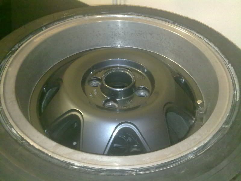

the better condition wheel after a clean
and the rest look like this, you can see the toffee coloured specs where the laquers bubbled and dirts got underneath
they have the metal type valve stems on them which will be really awkward to clean, sand and polish around so i might take them and get the tyres and valves taken off/out.

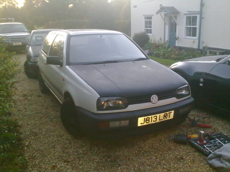

im back home this weekend so had another go at tackling the starting problem, tried another started motor, its clicking now but still not turning over, guy at the scrapyard in Coventry suggested it could be the ignition switch and gave me one to try but that made no difference either, so im well and truly stumped now
anyway here it is, looking sorry for itself in the driveway, not bothered about the tyre as its bald anyway and i have the cups to go on
atleast the lights look good  :grin:

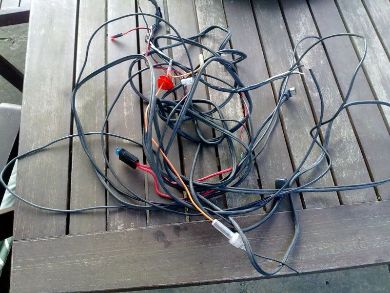

fiiiinaaally got the starting problem sorted(or so i hope... its been fine the last few days) which means i can get on with all the other jobs knowing im not wasting my time  :smiley:
so i ripped out the alarm system as it seemed to be causing problems and was just generally messy, plus i didnt have the key or anything for it so i would prefer to not have it there, wasnt too bad to remove, alot of wires though  :grin:

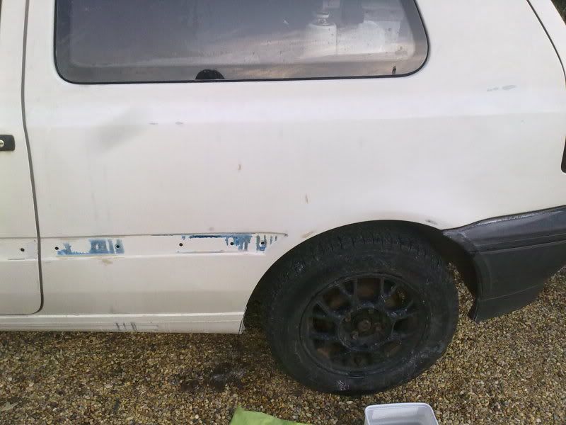

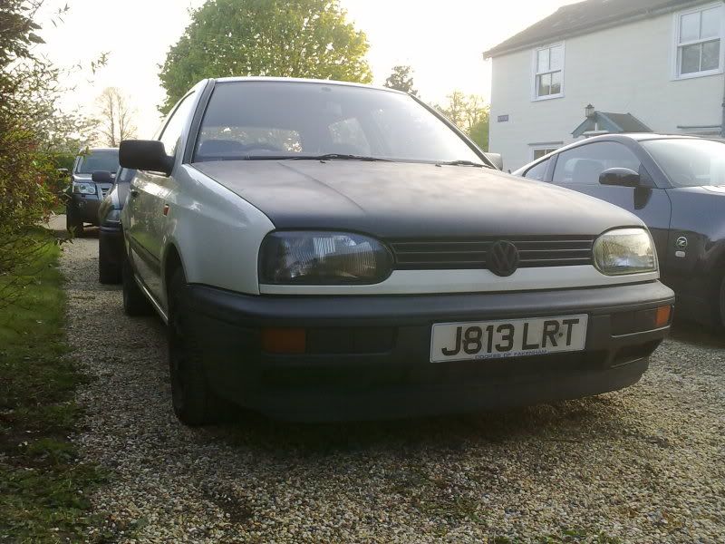

and today i sanded off the final little bits of those drips down the side, that panel was also pretty scratched and chipped so as my spray can seems to be a pretty good match i thought i would touch it all up, i'll update tomorrow with how its turned out

and heres the panel after paint, im really happy with how its turned out for a rattle can in the driveway job, its a bit patchy at the moment but should be good once its all T cutted

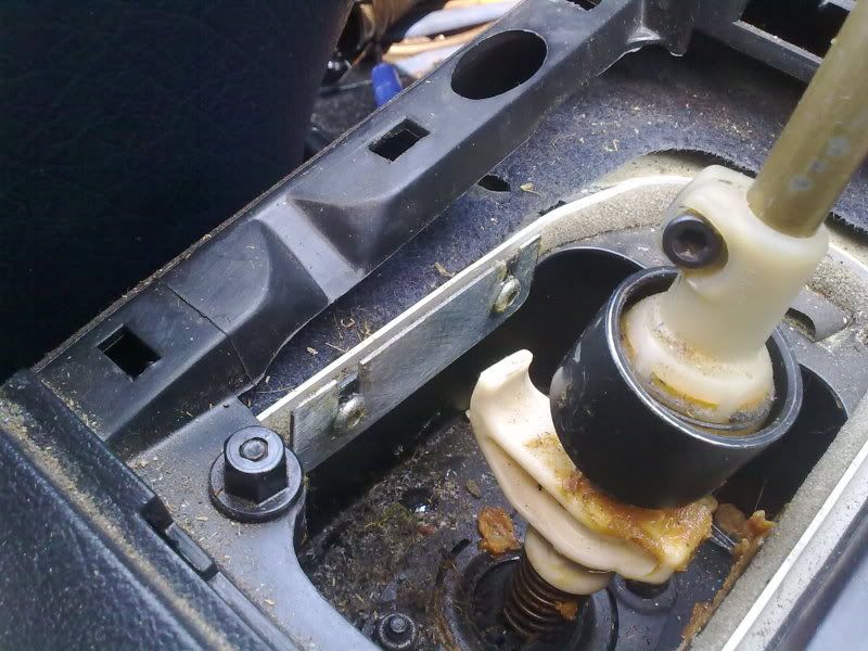

I also made a plate to solve my gearstick problem, the plastic hook on the gearstick that stops it engaging reverse without being pushed down had worn down to the point that it would go into reverse instead of 1st which is obviously pretty dangerous.
