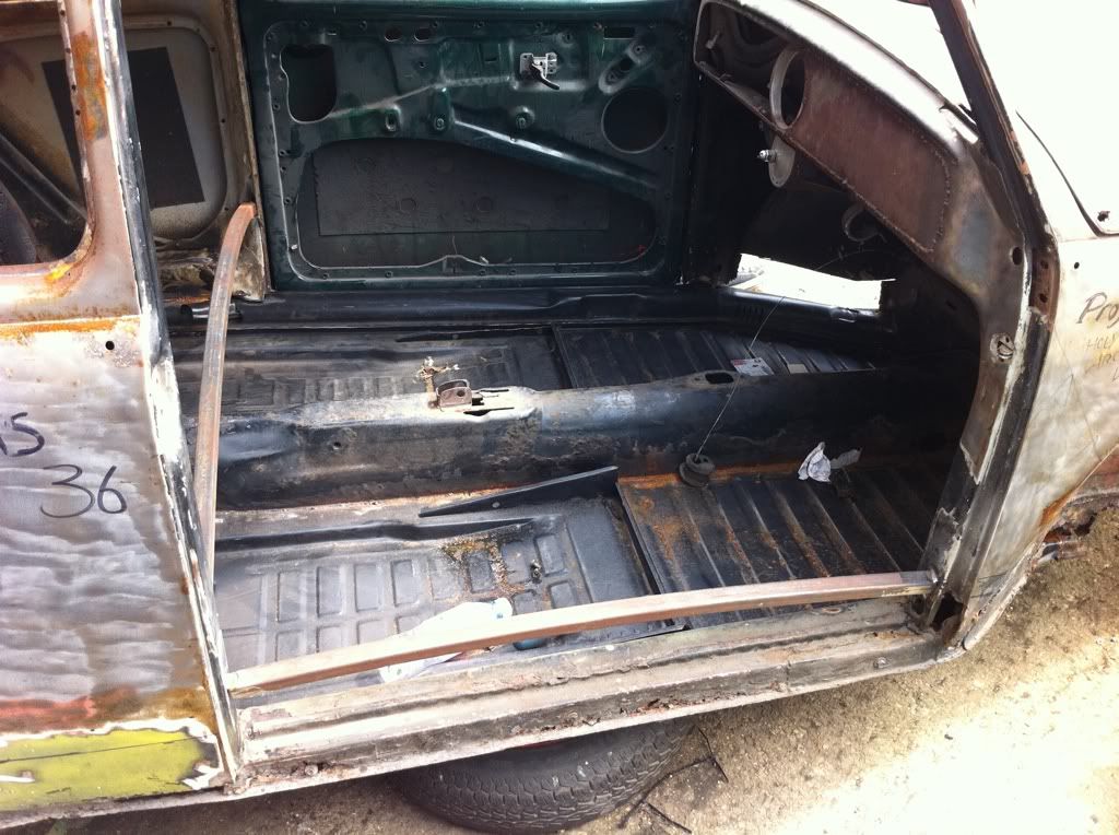

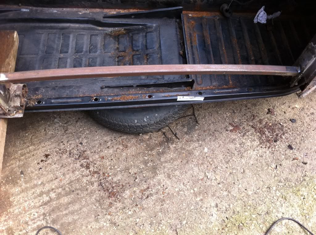

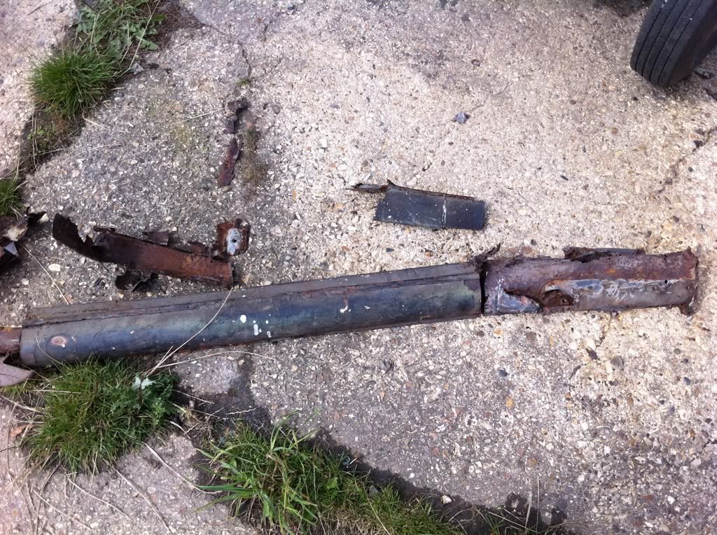

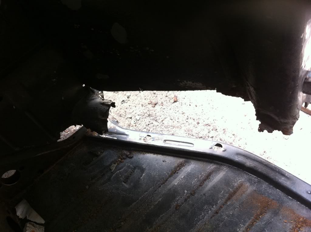

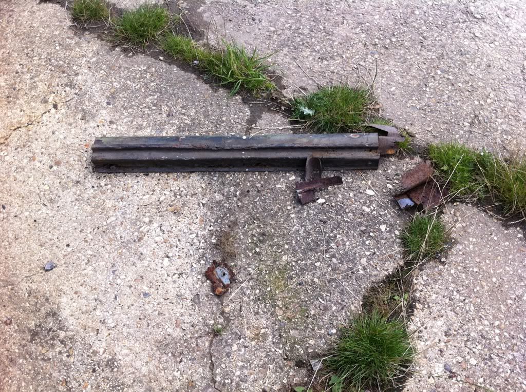

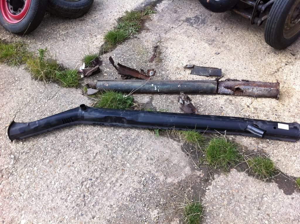

Had a good day today. Nipped up a mates shop to drop some money off and see his new bike he's finished then pulled a shift on the beetle. Got fed up by climbing in the back so took a door off and braced the shell some more. Then got the other heater channel out and new one bolted in. Just need to trim the bulkhead and then will tack it in, fully weld both sides, then start to channel the body. Anyway pics!

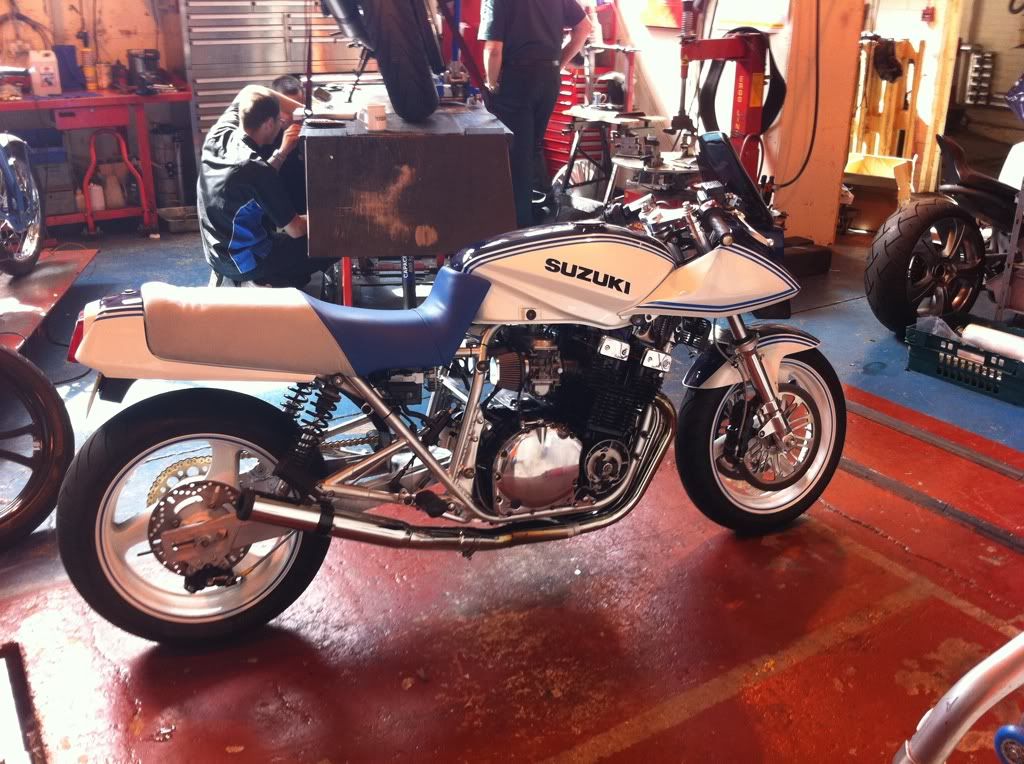

Is that a Suzuki Katana by the way? That takes me back to the mid eighties. My mate had one. Awsome bike!!

Yeah man katana gsx1100, but with Honda firestorm front end with performance machine brakes, firestorm back end and a stretched swingarm to make it look a bit chunkier/meaner.

good work on the heater chanels. i like the bike, i may have to build my cbr 750 up. thts on a e reg i thing. old looking bikes are awesome
