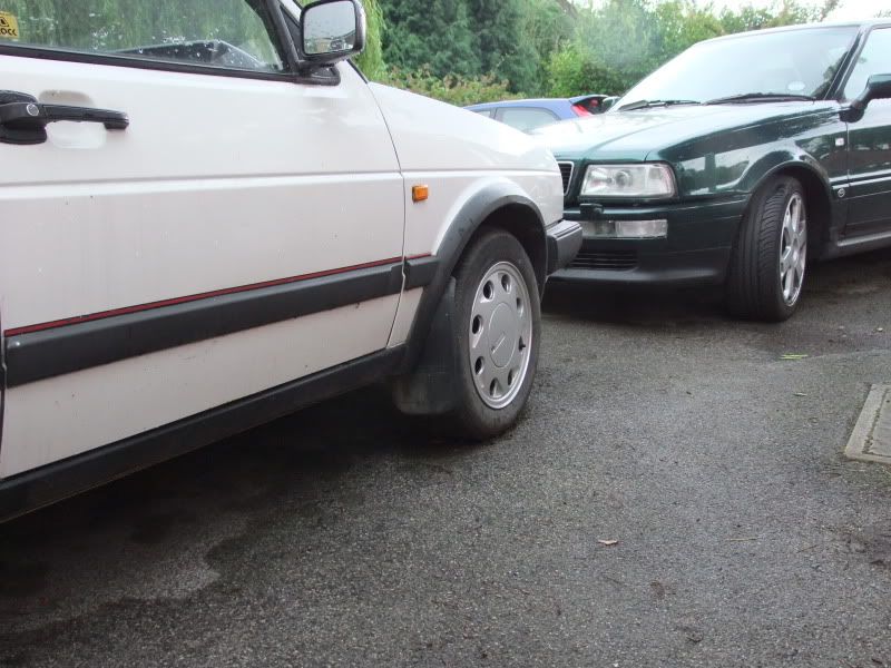

Its not as big a drop as you might think...
Before;
after fitting to the front only;
I don't have any pics with both front & back fitted..
Massive improvent to handling... "Pay yer money and takes yer choice" M8 TBH...

« Reply #5 on: 15 July 2010, 13:17 »
Thanks and mice motor. :cool:
How long did you drive it with rear standards / uprated fronts?
How did it feel?
I thought it would have looked a lot lower than that.

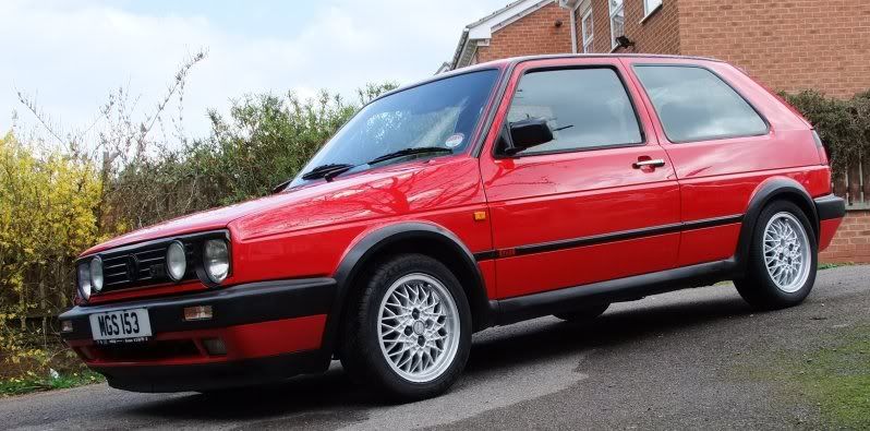

Here are some pics of my 8V with 'em fitted and settled down...
Here is a couple of pics of my other 8V with OEM springs etc..
As you can see she look's much better without being silly low...
Ride and handeling is MUCH better too..
