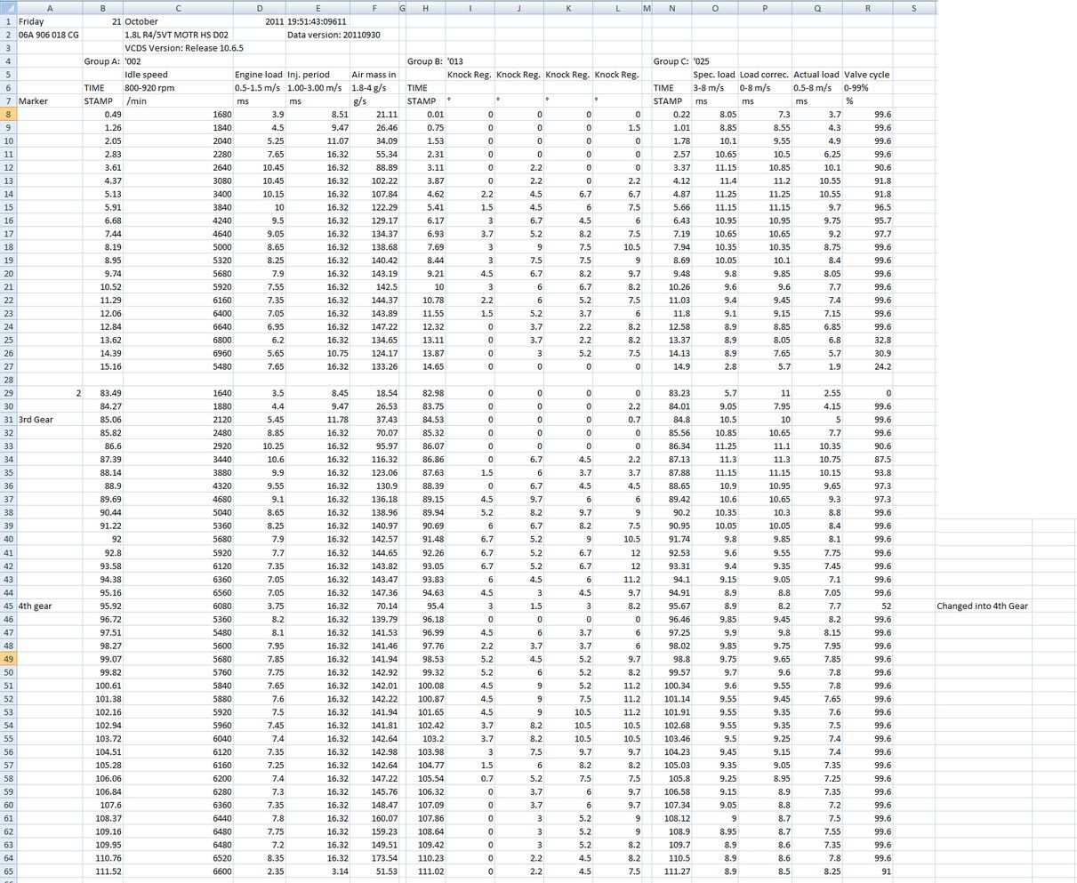

Heres a few figures for you.  Runs were done in 3rd gear: ~1500rpm - 7200rpm redline.  (one set of logs has a 3rd - 4th gearchange in which is shown in results.)
*obvilously the MAF needs scalling for the % increase in surface area.  (off to google i go!)
Heres the logs in excel form for people to play around with:
http://hostapix.co.uk/excel/248bhplogstrimmed.xlsx
Trimmed them down to remove rundown / time between logs.
Click For Build Thread

« Reply #259 on: 21 October 2011, 20:32 »
Whats stock diameter and whats the new diameter? 2.5" to 2.75"?
Remember πr² equals area, puts the two area's over each other to work out the percentage and go from there, or let me know the MAF sizes and I'll work out the percentage increase... or in theroy it would be:
2.75/2.5 = 1.1
so you would times the cross section by 1.1...
2.5 * 1.1 = 2.75  :smiley:
or 1.1 is the same as 110%, so 2.5*110% = 2.75
