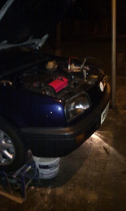

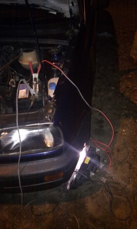

Set off to take the sump off at 8PM.  :grin:
No power the other side of the road, torches like men.
Soooooo:
Got stuck on two already rounded bolts. Will be trying again tomorrow as it got late, or out comes the drill.

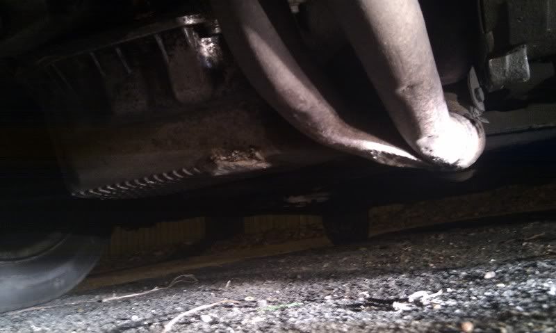

The massive bangs twice now over speed bumps were the sump and the exhaust. Manifold already had a crack, the downpipe is worn with the brackets snapped, cat looks a bit rusted, I hate the backbox.
What's that I hear?
££££  :rolleyes:
Will look at buying the bits bit by bit but I don't want cheap and nasty parts.
Where all my moneys went.

whats the paint for  :laugh:

Oil drainer.

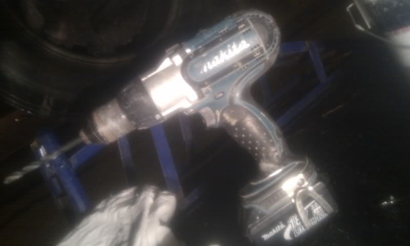

  • Posts: 2,718

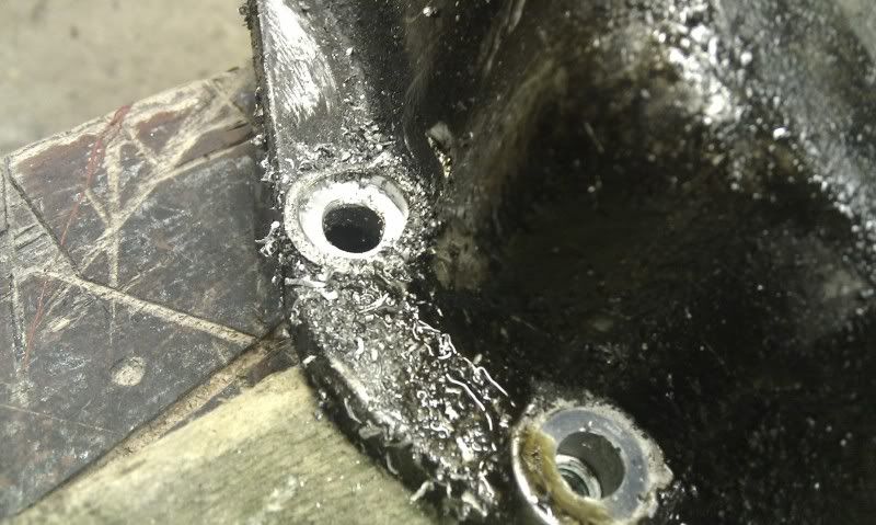

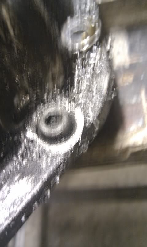

Bolts didn't want to know. Stupidly, stupidly tight. Actually thought I had snapped the allen key undoing each one. Such a loud SNAP as they loosened. But all the threads were free as.
So out came the Makita and his freinds.  :evil:
It lol'd at the bolts and even on speed 2 out of 3, whch has packed up, ripped through them.
Unfortunately I chivved up the sump a bit around the bolts which was to be expected, but I thought I'd make them some flat seats.
Unfortunately, the strainer is completely fine. The pump looks absolutely fine. The chain has a bit of play. I assume they aren't designed to be replacable?
The oil is DARRRK black after only 1300 miles. I'm hoping this is the issue. I will be flushing it out with cheap oil twice. Then giving it some more Castrol.
Otherwise I will have to borrow an oil pressure tester then look at the switches.
I've ground down the marks in the sump, will fill the rest (not deep at all) with chemical metal then hammerite it. Either black or white then pink it out.  :grin:

That work lamp is fcuking genius! Good work!
Offline Bellend
  • Posts: 2,718
Cheers.  :grin: Was good til the radio cut out cause the battery was flat.  :grin:
