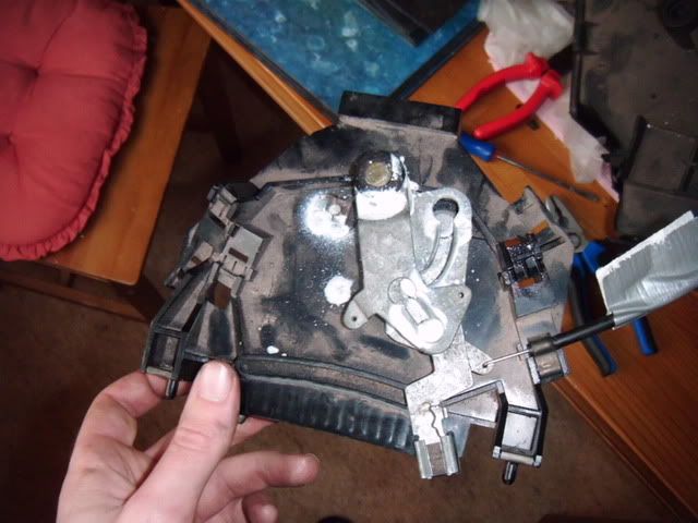

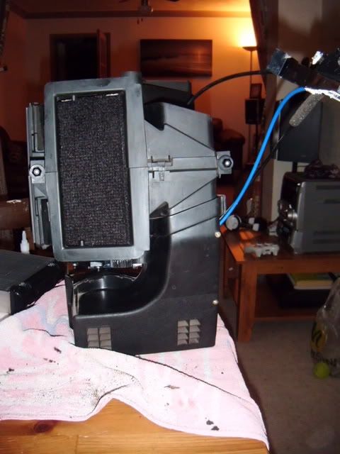

Well the old matrix was causing the screen to mist up  :sick: plus it wasnt getting very hot.
Today I recovered the heater box flaps (air temp & face) with some carpet as I had no foam
Before:
After:
The cables and the sliding mechanisms got a good splatting of grease:
Speaking of cables, the feet vents were constantly blowing so I adjusted the cables accordingly. Took some figuring out  :laugh:
Still no more progress with the wiring, but the heater box c/w fresh new matrix will be refitted this week, and it all falls into place after that
