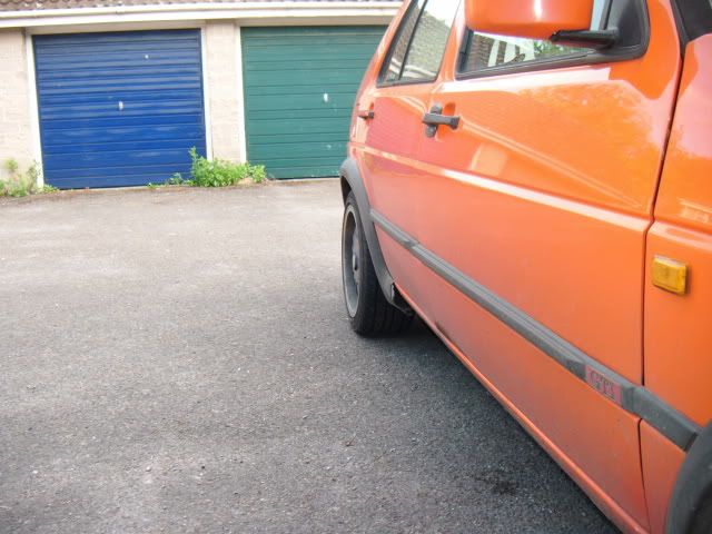

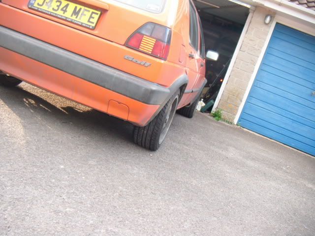

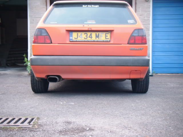

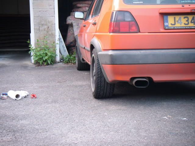

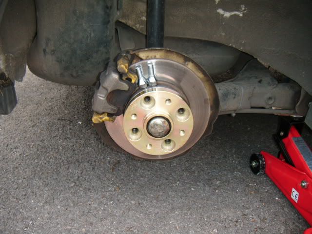

here we go boys and girls:
Before:
After:
Before:
After:
Some more random shots:

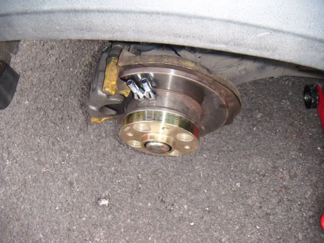

Oh and make sure you have proper VAG wheel bolts as my car had longer bolts than normal, so the wheel bolts bottomed out on the disc  :undecided: ... Nicked the correct bolts from her-in-doors' mk3  :grin:

havent driven it yet  :tongue: but it gave me chance to tighten the rear wheel bearings up as theyve settled now
Looking good :afro:
Where did you get them from??
http://cgi.ebay.co.uk/ws/eBayISAPI.dll?ViewItem&item=390158230124
oh and you'll need to threadlock the spacer bolts (NOT the wheel bolts obviously) to ensure the spacer (and therefore your wheel) doesnt fall off the disk!
also when the car is jacked up, put the handbrake on tighten the spacer bolts up otherwise you wont be able to tighten them up enough.  :smiley:

« Reply #67 on: 14 May 2010, 08:44 »
Threadlock is a must, I found that out the scary way when I had spacers on the front.
I stopped so no harm done but fook me it was scary :grin:

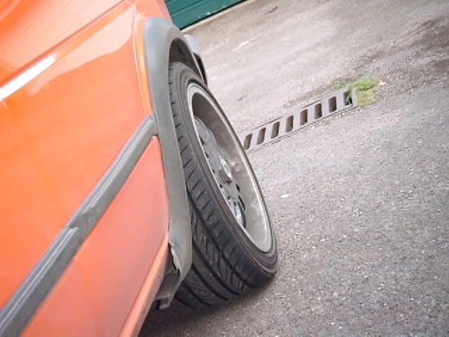

Cleaned my wheels today... if anybody has some tips on keeping polished rims looking shiney, please let me know!
Before:
After:
