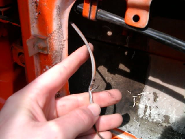

needed to get the central locking working off the alarm remote, as this suddenly stopped operating. traced it to this:
worn through wiring  :huh:

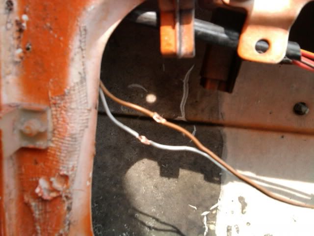

cut it out and soldered/heatshrinked the wires

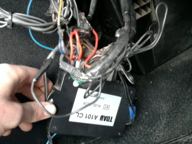

it still wouldnt work  :angry: so had to dig the alarm out to trace a blown fuse on the alarm loom:
yeh so thats a right mess! once i convert my replacement centre console to a Votex style one i'll tidy the alarm wiring up  :cool: One of the reasons for a Votex style console is to use one of the DIN slot covers as a back plate for the start switch rather than the aluminium effort thats jammed into the ashtray at the moment:

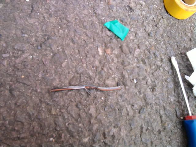

Then i went about sorting the 10v issue on the main loom which feeds pretty much everything, in the end it resulted in the car being stranded as it wouldnt start.
traced it to the terminal block in the engine bay (as battery is in the boot), one of the cables was burnt through as it was too thin  :angry:

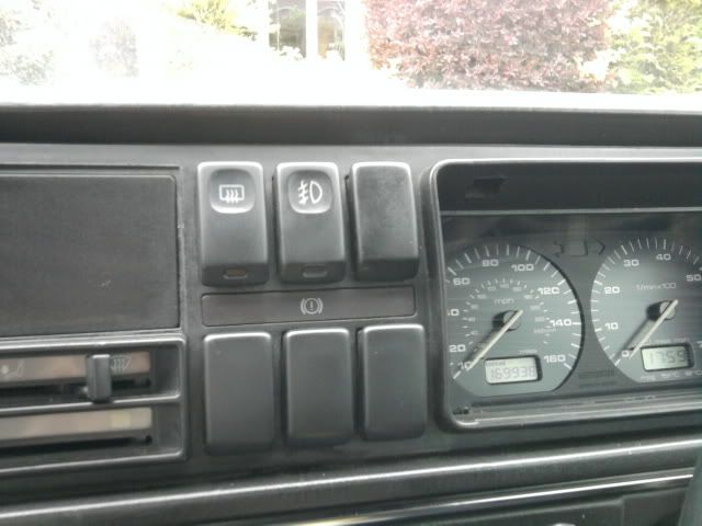

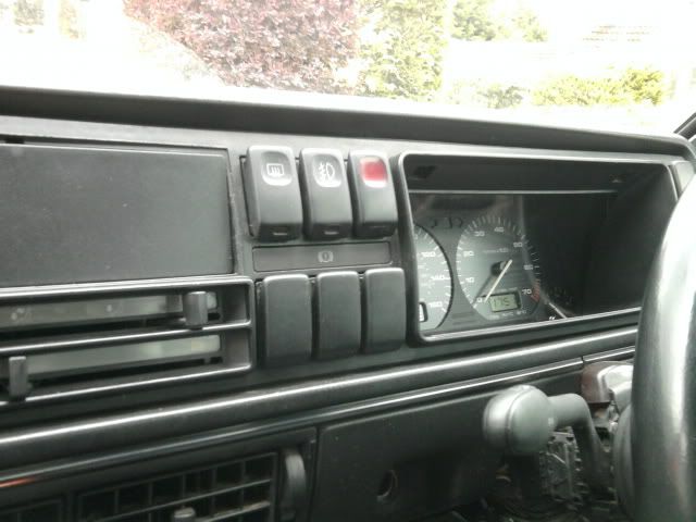

didnt use one of the switches on the dash:
so got a new switch blank:

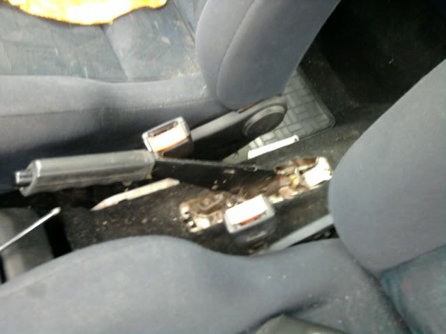

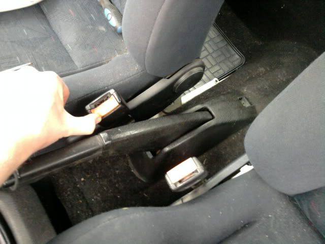

handbrake was missing its trim:
sorted:

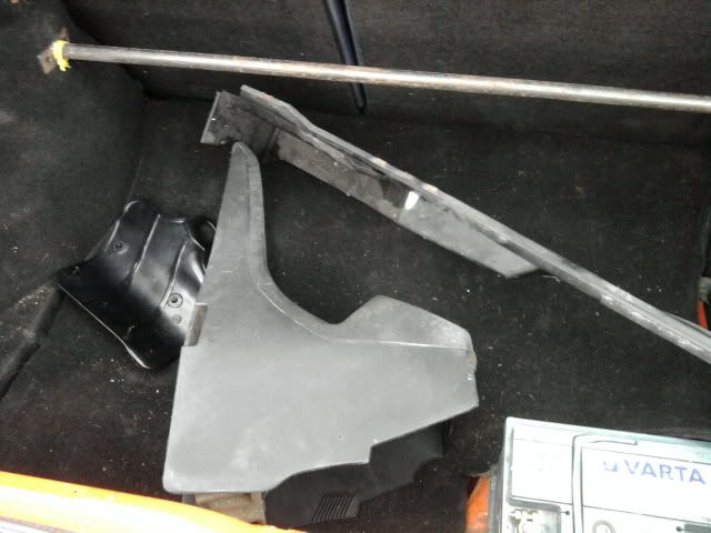

Rear strut top was missing a cover but got this from mattneck too, couldnt be arsed to take a pic of this  :lipsrsealed:
