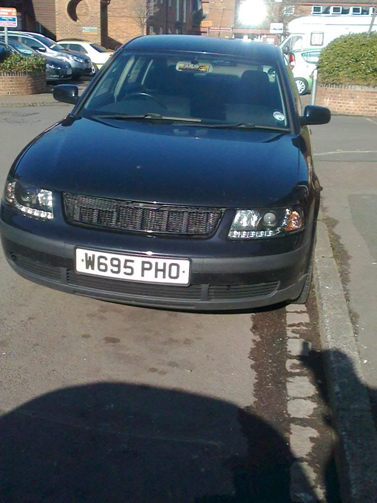

Car has been working fine for a while now so thought I would treat it to a new grille.
