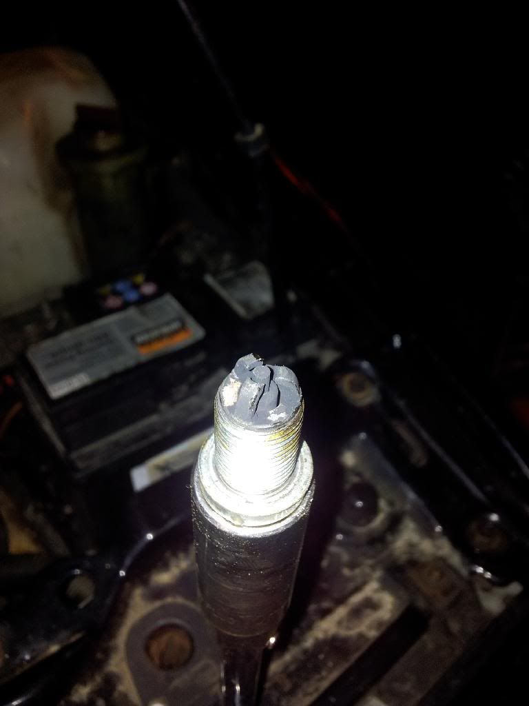

A little light servicing tonight.  Oil and filter change and then swapped out these:
For these
Doesn't like being drowned - gets a right hump on and needs to sit for a couple of minutes after immersion, as it won't rev up, just gives what can only be described as an almighty lambda cycle.
For these
Probably replace the crank sensor to try and sort that out and check the engine loom carefully.
Mine has just started doing this aswell. If I leave it to idle it runs rough for a while.
If I drive straight away it's fine

« Reply #249 on: 24 December 2013, 09:05 »
I bet it's the b*starding crank sensor.  I'll let you know when I've replaced mine... might not be for a couple of weeks, unless it gets worse.
