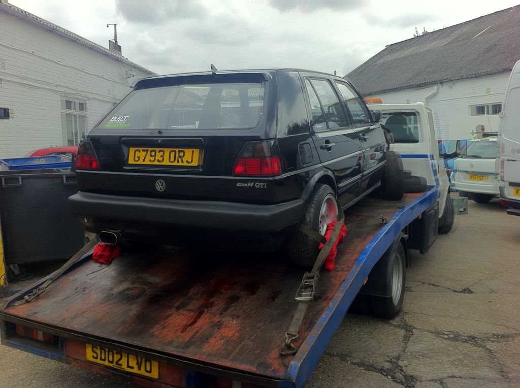

Thought id update my main build thread.
Its off for paint in the engine bay! Huge thing to tick off the list - its now just a case of getting all the little bits (and theres a lot!) together, installed then bolting the engine in.
off it goes!  Hoping to have it back for next saturday.
