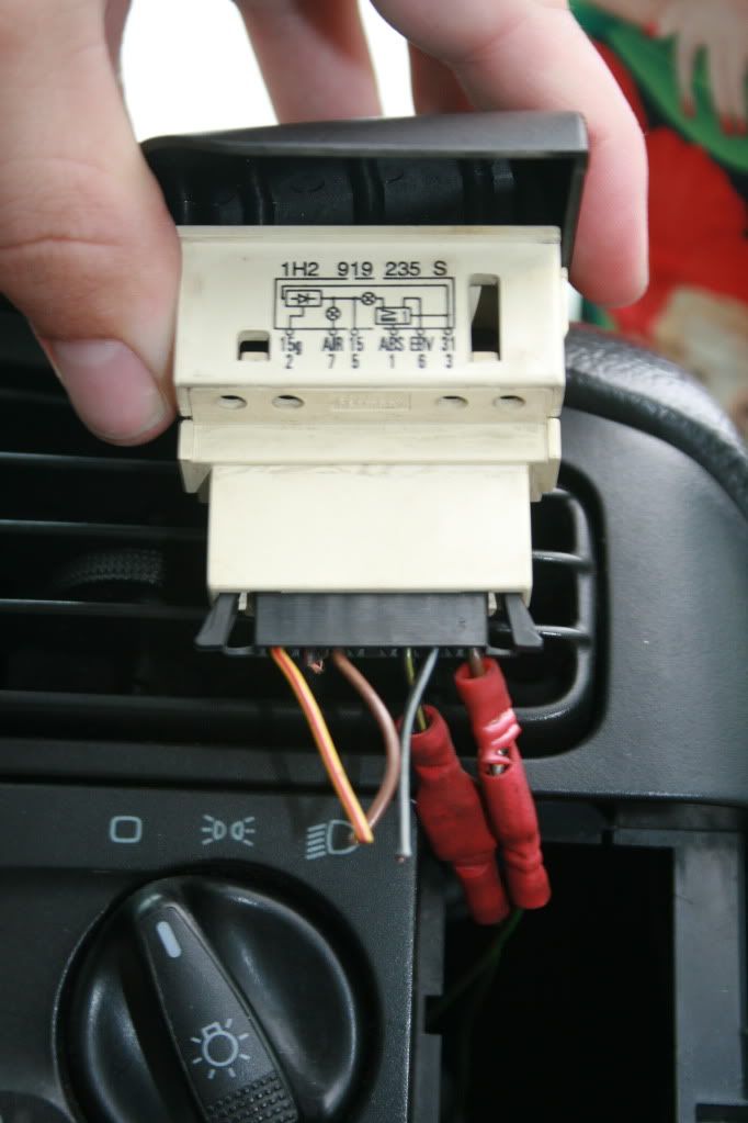

after reading about how the abs light should light up on ignition i got worried when i checked mine and it didnt.
popped out the cover bit to find this
not the greatest thing to find is it. airbag im not worried about as im getting a new steering wheel soon but can anyone tell me what the other wires do please ?
heres how the dash looks on the first turn of the key just for reference.

If you get hold of a wiring diagram all you need to do is match up as per the numbers on the plug.
I would think it has a fault.

i had a look and the abs still seems to be plugged in but its the
"15g, 15, EBV and 31" (as shown in the pic) that i have no idea what they are referencing to

wiring diagrammes..check this site http://volkswagen.msk.ru/

If they have been cut, the wires should still be in the dash, so just match the colours back up surely?!

indeed but i was more worried about what they were and why they may of been cut...

Simples. to hide faults.

Yes my abs bulb had been removed before I bought my car to hide the fact that three sensors had gone. Had to buy a light unit as  well as the sensors.

i take it these would be picked up with a diagnostics thing (sorry for the lack of technical terms)
