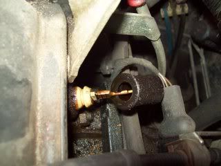

oil pressure sender on the side off the engine just had mine fix £8  from vw

was an oil pressure sensor for me

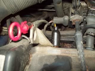

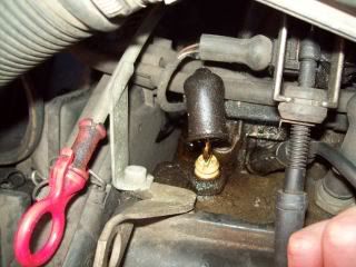

It seems to be coming from a sensor at the front of the engine on top of where the oil filter is? Is that the oil presure sensor?

My Mk.3 Valver developed a small leak from the oil pressure sender just above the filter.
S.M.
oil pressure sender as quoted above in this thread  :wink:
