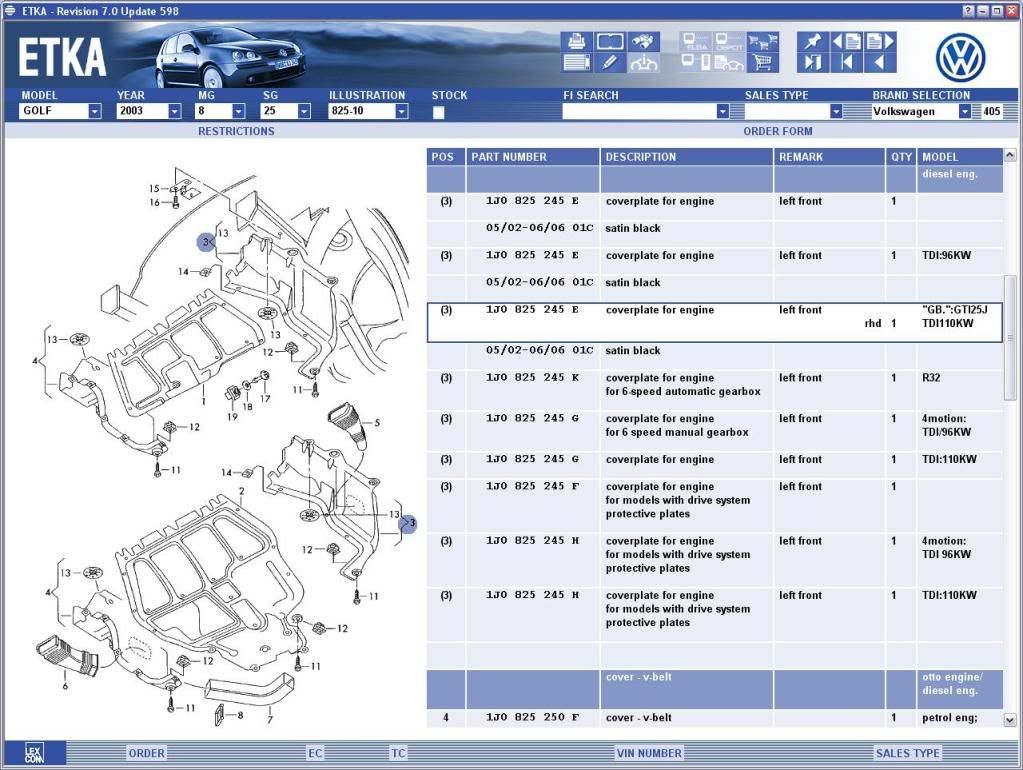

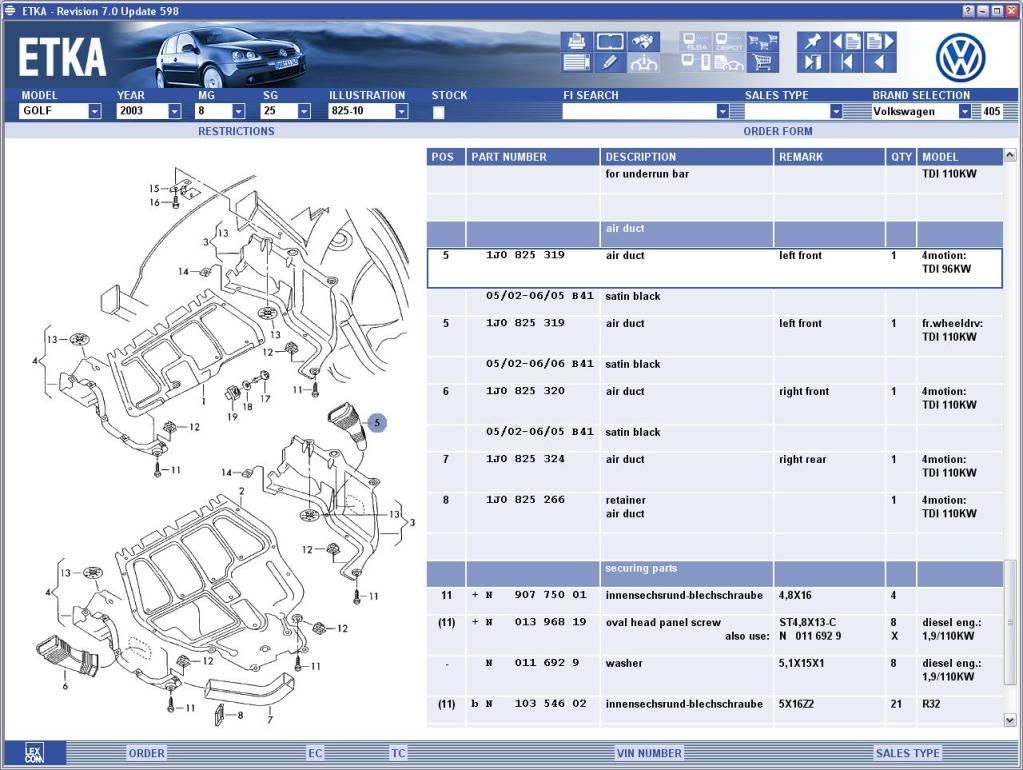

Julia I wouldn't worry about it the annis dont have it so just remove it when the valance is fitted  :smiley:
because the TDI 150 is the only MK4 with a FMIC as standard, and all the other MK4s have their air feed in the bumper vent where the external temp sensor is.
looking at ETKA the side cover is a different part number for the PD Anni, i wouldn't worry too much, and you can fix it with some hose
pics below
note parts numbers end E and G (I can confirm all the parts for the PD 150 do end G as I've replaced all of mine)
note no mention of GTI25
be interesting if someone with a PD anni could tell us what it actually looks like
