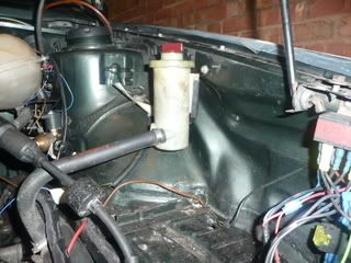

Here is mine out of a seat toledo. mounting studs are already there too

thats the corrado setup, good to know it can be found in SEAT as well, easier to find in scrappies!

« Reply #9 on: 17 February 2009, 17:07 »
Ah that looks like a much better size, could even squeeze in here:
