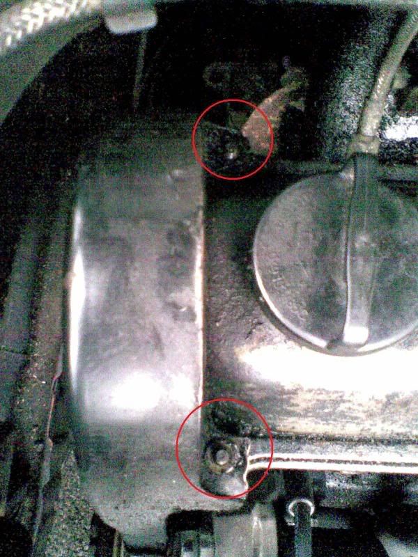

these bolts in red, are undone. but the cover wont budge.

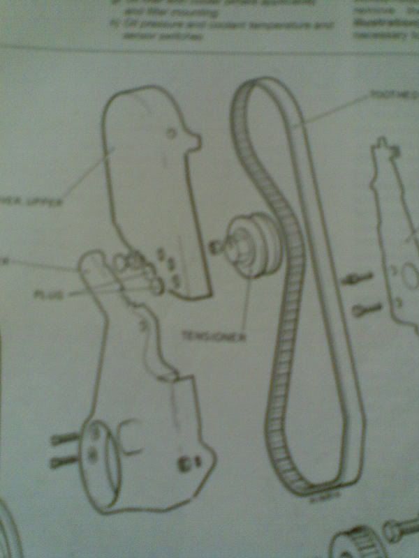

haynes and bently say remove the rubber plug to get to allen key and "retaining clips" shown here

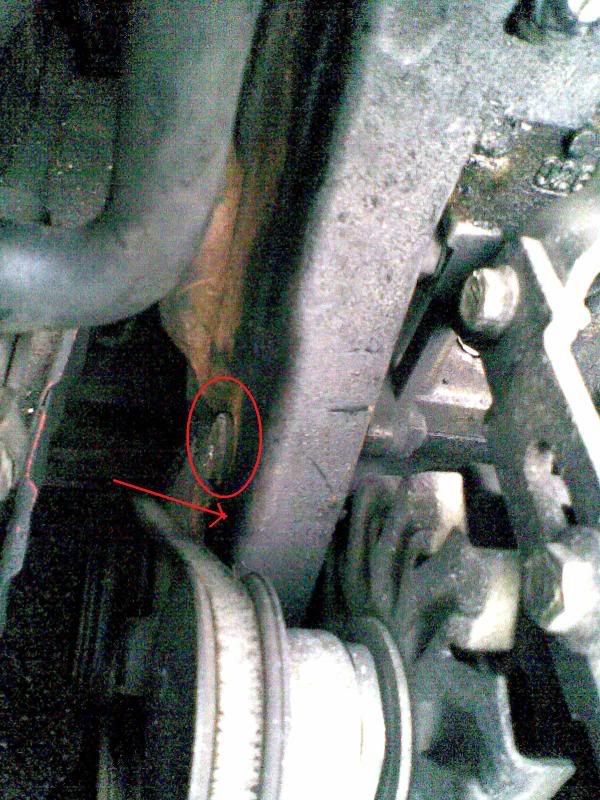

I have removed the rubber plug covering the clips but have no idea how to undo them as i cant see into them due to the angle.
circled here is what i un did and did up again. the arrow points to the clips.
