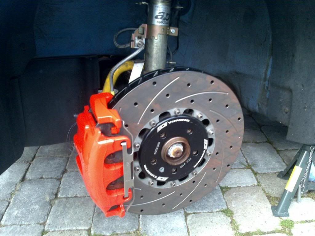

My new front brakes are on, i fitted them myself and bled them with the EZbleed system from halfords and i have to say it has done a rubbish job! Pedal is spongy and horrible!  I am still waiting on my new rear brakes to come so i can fit them and then take the car to somewhere local and get them all bled properly!
The front brakes are Standard Mk4 R32 Calipers that have been fully Refurbished and rebuilt with new parts and finished in powdercoated Red.  I am using standard Genuine VW pads.  The lines i am using are 200 Spec Goodridge Braided Hoses.  I have also had a Tyrolsport caliper stiffening kit fitted to the calipers (http://www.tyrolsport.com/index.php?p=product&id=125&parent=64).
The discs are two piece ECS Tuning Discs that have been stripped down, the small bolts have been nickel plated and the edge of the discs have been painted black so they are easier to clean and wont rust up.
Here's a pic without the wheel on.  Will get a picture with the wheel on when the car is cleaner!

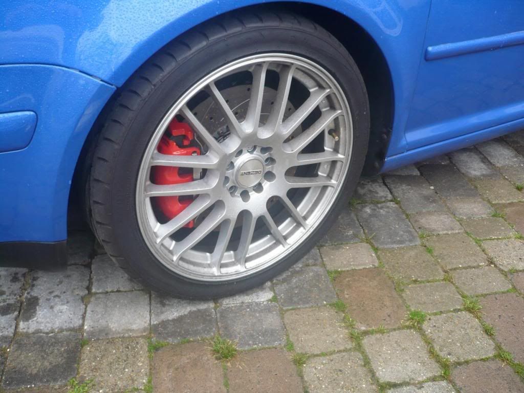

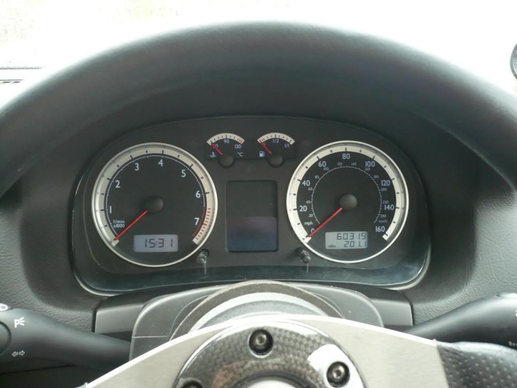

Just took a quick picture with the brakes behind a nice dirty wheel!
I also got some Bora Sport clocks fitted a couple of weeks ago.  They have lit needles and miles to empty enabled.

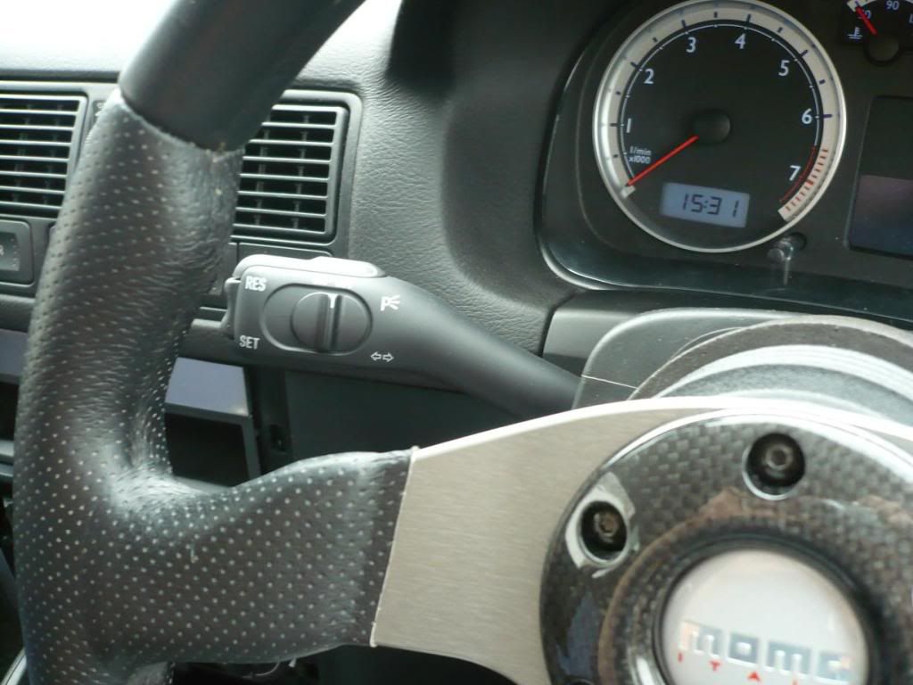

Also i fitted OEM cruise control.

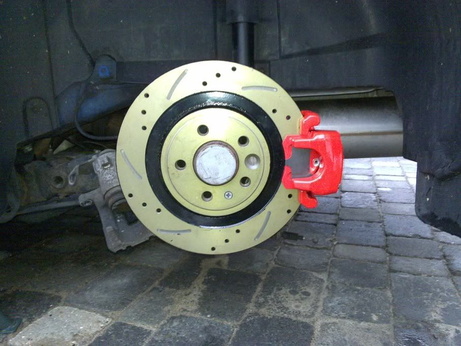

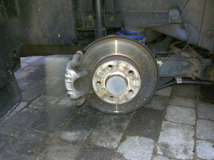

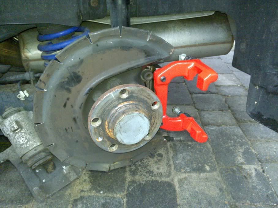

Also this week i recieved my long awaited rear brake upgrade, so i fitted them the day after. I am taking the car to Ad Autotechnik tommorow to get them all bled after hearing how good they are from Barry.
The Brakes are R32 Rear Calipers that have been fully stripped down, re built and then powder coated red.  The discs are 284mm MG disks that have been drilled and modified to fit.  Also i have had them drilled and grooved in the same way to match my ECS fronts, along with the outsides and middle of the disc painted black again to match my fronts.  Am using a set of DaveB spacers on the caliper carriers to allow for the massive discs.  Also using a nice new set of EBC redstuff pads.
Heres a few pics from when i was fitting them!

your splash guard looks a bit neater than mine! lol...
Maybe i wont invite you to do half hearted jobs on my car no more lol
looking sweeeeet matey, did you get them bled or is it booked in?
Lol sorry mate! I had my Tin Snips back when i did mine so managed to cut them!

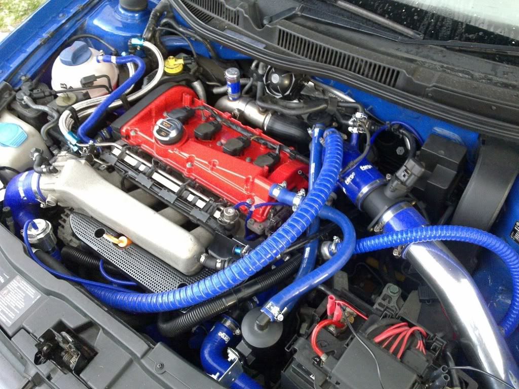

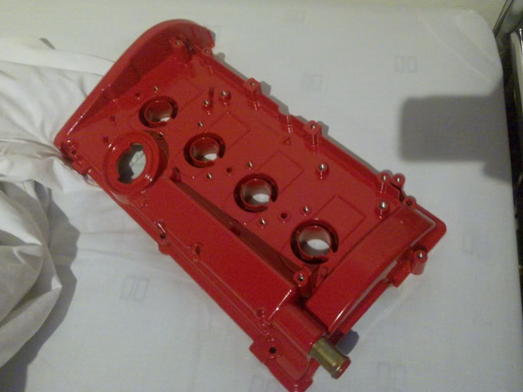

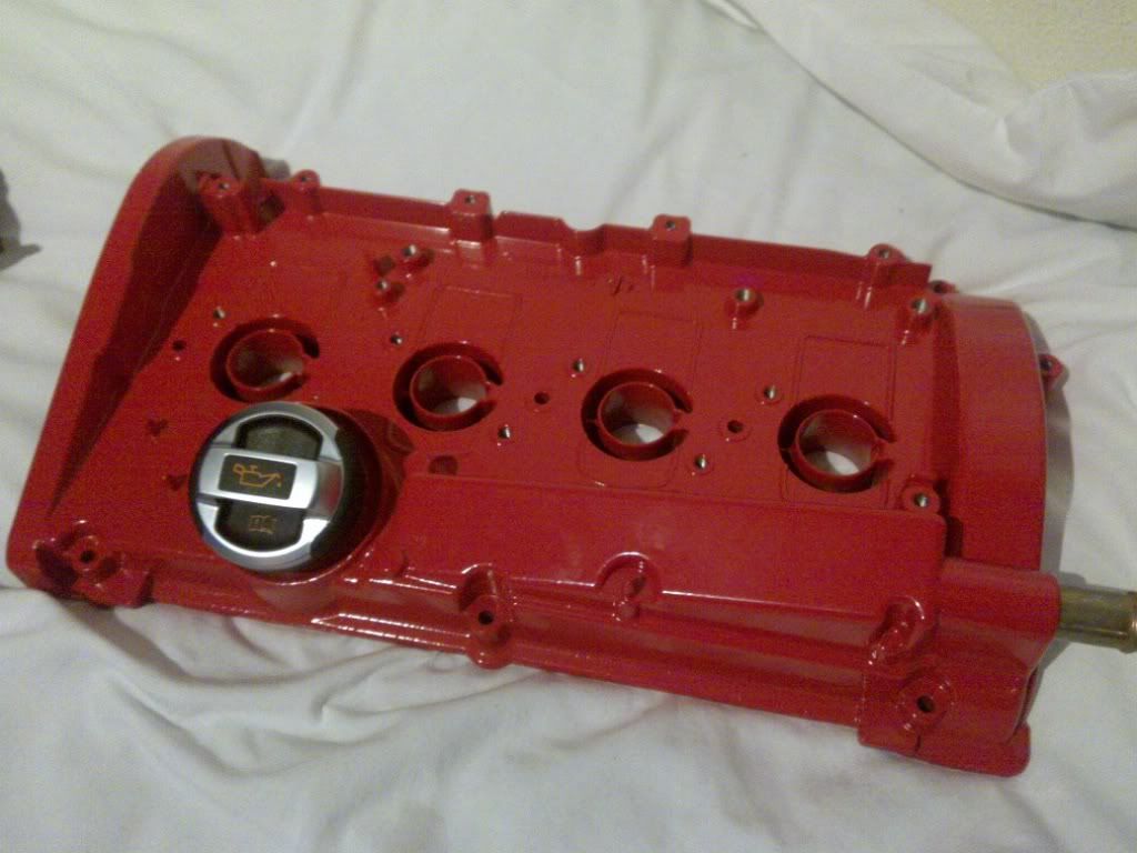

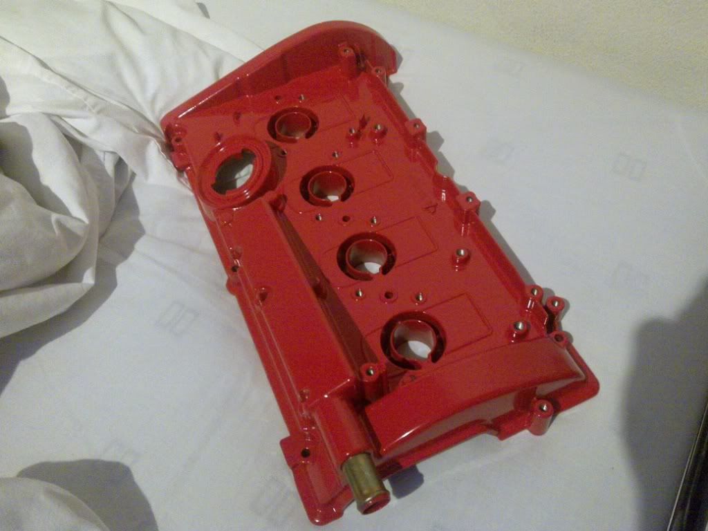

First thing will be to fit a brand new Rocker cover that i have had powder coated bright red and to give the bay a general clean up!
After this i am going to be spraying all of my interior trim and also taking out the rear seats and spare wheel for good.
Here's a pic of my lovely new rocker cover! Was a bargain £38 off ebay and cost me £35 to get poder coated.  Sorry about the crappy quality of the pics have just taken them on my camera phone.

Well after going round Tim's yesterday and giving him a hand i thought i would get my ass in gear and actually do something to my car as i havent even touched it since it went up on axel stands waiting for the rear caliper to come back to me!  I put on my nice new rocker cover! And also in the pics below you can see my catch can install  :smiley:
Also: The caliper should be back with me on Tuesday fingers crossed so i can fit it, get the brakes bled and get the clutch fitted all before the R-Tech rolling road day.  My harnesses have come from Demon Tweeks but am still waiting on the Cobra Subframes as they were shut all over Christmas so fingers crossed i will have fitted them by next weekend aswel.
Sorry for the crappy quality pics only had my phone outside.
