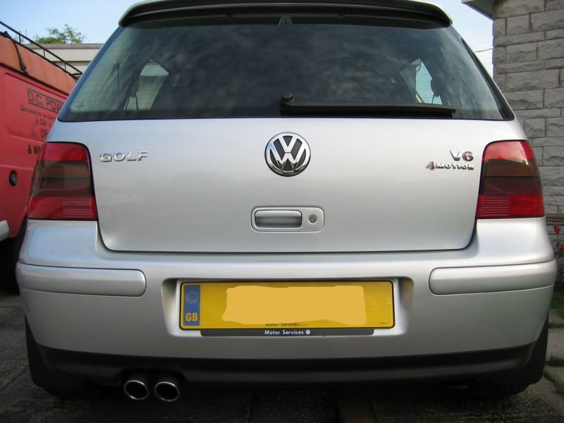

This is my old 4Motion with the Skoda Fabia wiper fitted. It had to be modified to clear the spoiler though!
