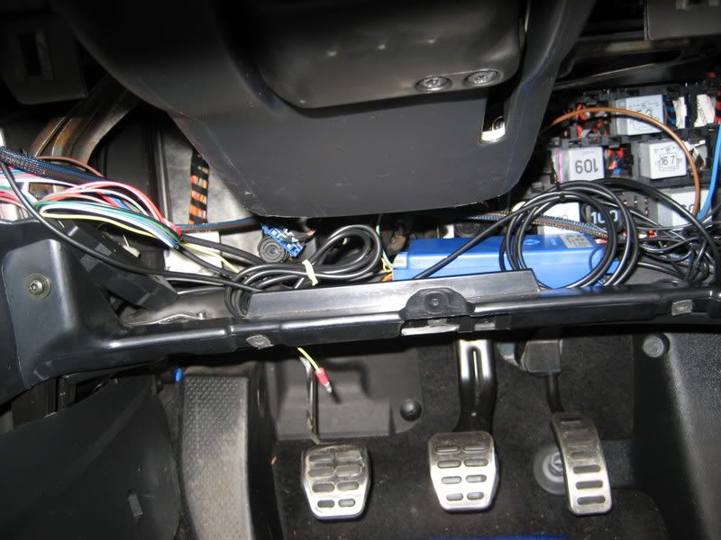

i'm assuming he has routed under the steering wheel
to do this you need to remove the trim - start by removing the fuse panel and cover on the drivers side of the dash (open the door)
then remove 2 x Torx 10 screws and then pull the trim out and away
then remove 5/7 other screws to allow you to remove thre trim behind that giving you plenty of room
here's a pic of under the steering wheel
to remove the ashtray pull out the bit in the ashtray to reveal a screw and remove that
now grab inside the ashtray and pull up towards you - don't pull to hard as you have to disconnect the plug for the lighter behind
you might have to remove the headunit too - not 100% sure but removing the above should allow enough room to route the cable upto your location

Thanks for the pics and the info Rhyso  :smiley:

That all looks far too 'wire-y' for me!! I didnt remove anything, unscrew anything or move anything- I'm no Rhyso!!.  It can be put behind the dash without doing it, but could be more 'half-hearted' I suppose.
lol - all those wires was my old bluetooth car kit!! Which way have you routed the cable then mate?
