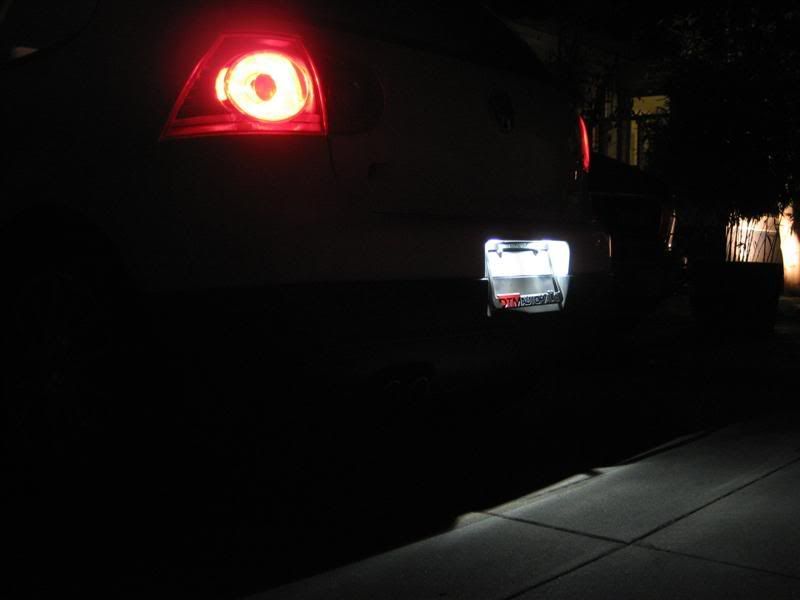

Have a look at the whiteness on these (from a post on golfmkv.com)
These are non-led bulbs

Steve P are those the Polarg bulbs? I read a few posts where people were having problems with the heat they generated in the lamp housing
resulted in a melted lamp housing!
The thing with the LED bulbs is that you need a resistor in line, so that a certain amount of current is drawn and the car thinks it has a normal bulb installed. Just as WhiteGTI said if you just have an LED bulb installed less current is drawn and the car thinks that it has a bulb out. There is a Japaenese company, can't think of their name at the moment, who do LED numberplate bulb with resistors built in. However, when I last looked they were around £50

Quote from: WobGTI on 30 September 2008, 16:27
are these lights def legal?
Providing the actual bulbs are "E" marked (and not counterfit), and they emit a "white" light, then they are completely legal. For info, VW actually sell genuine OEM blue W5W bulbs for the sides. None available from VW for the numberplate though.
EDIT: the specific ones shown on the GolfMk5.com link are NOT UK/EU legal - cheap chinese/korean crap.
