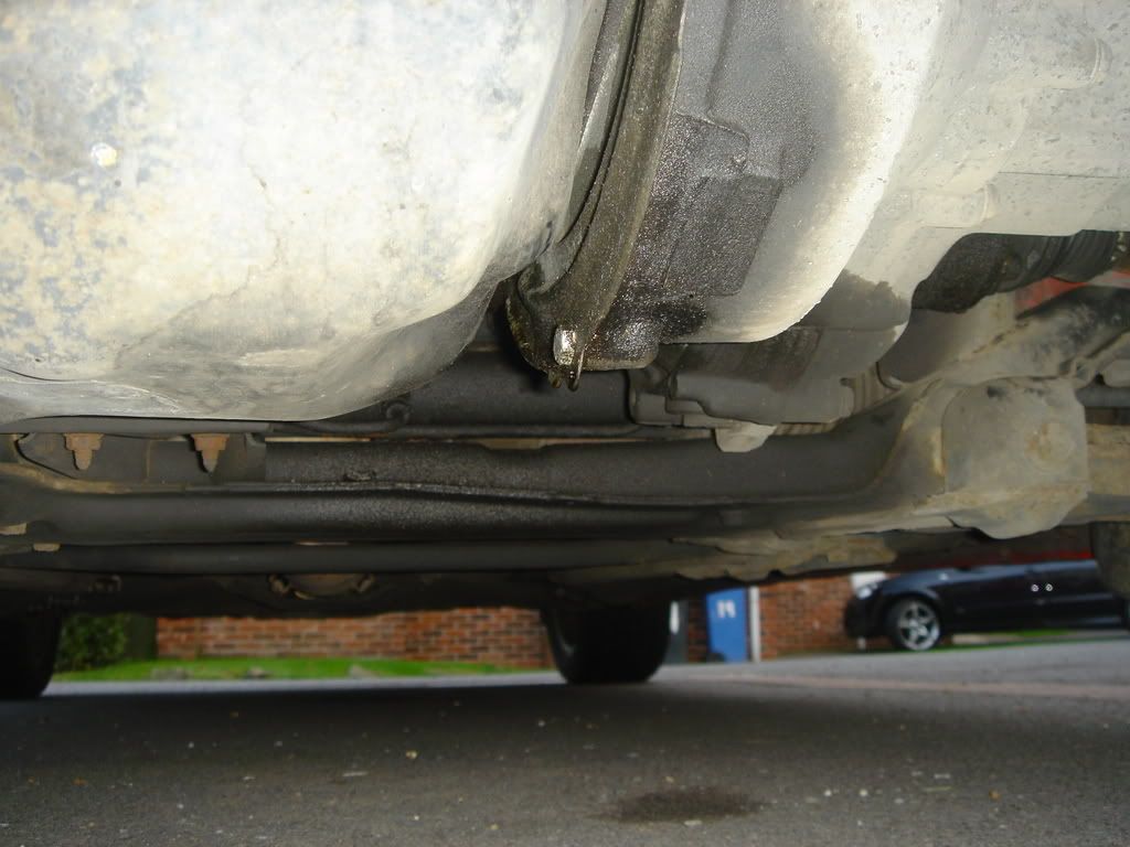

Hi,
is this a leaking gearbox?

could be the input shaft seel or the engine seel, sniff the oil, if it smells like strong mineral oil its gearbox, if it smels like normal engine oil its from the engine.

Yeah that is the gearbox mate looks, had mine changed the other week and looks like its leaking from the same place, if your lucky might just be a seal
