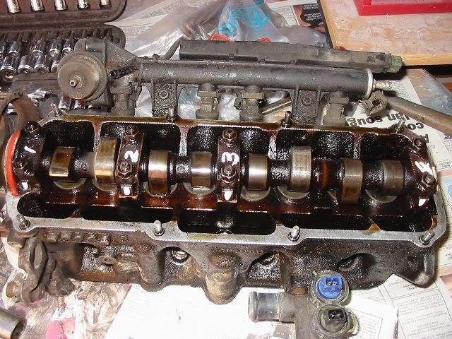

Heads off
Is there supposed to be only 4 bearing caps on here?

If you are talking Cam shaft then yes, they are off set and it does look like there should be one more. Just remember that when you start stripping to mark everything up or at least, put the things you take off back the way you originaly found them.

Can already see the tip-ex marks, knows what to do already by the seems of things
