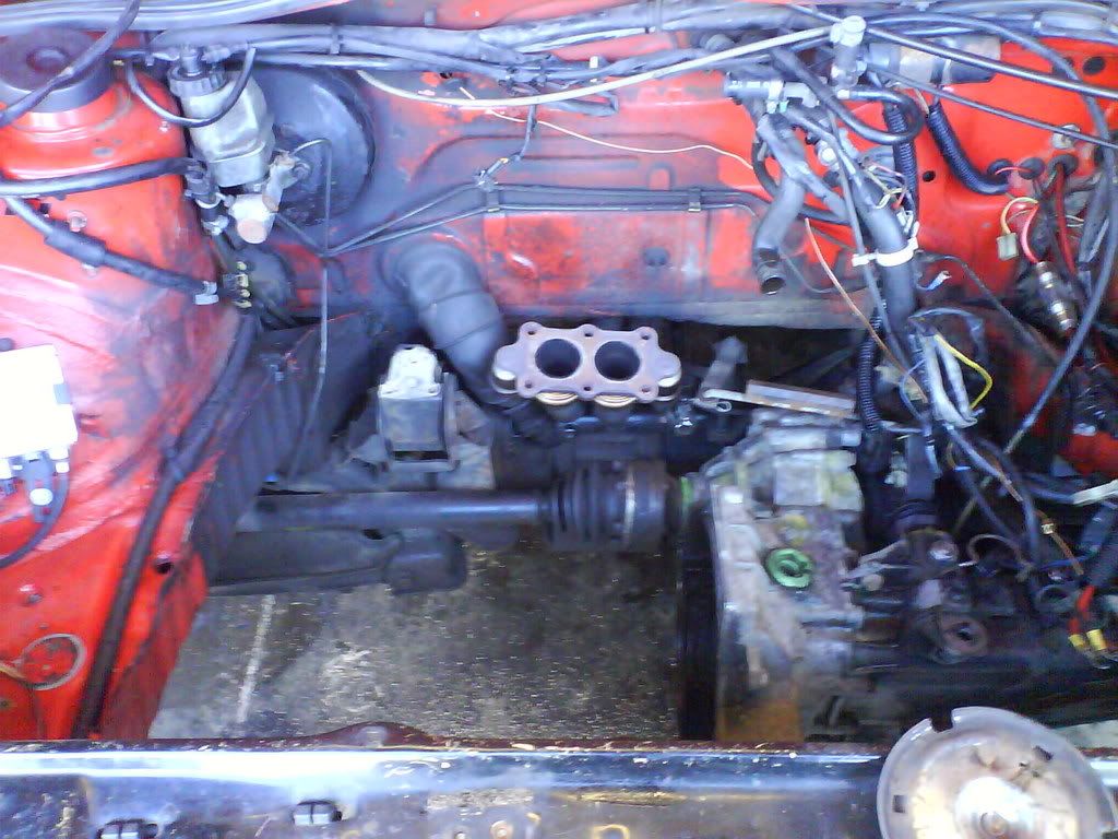

3~My personal favourite, but most difficult. undo bellhousing, pipes, front and rear engine mount. bottom pulley and water pump pulley(for extra clearance), exhaust and other little bits. slide the engine off the box and hoist it out of there!Should look like this
Hope that helps...............
