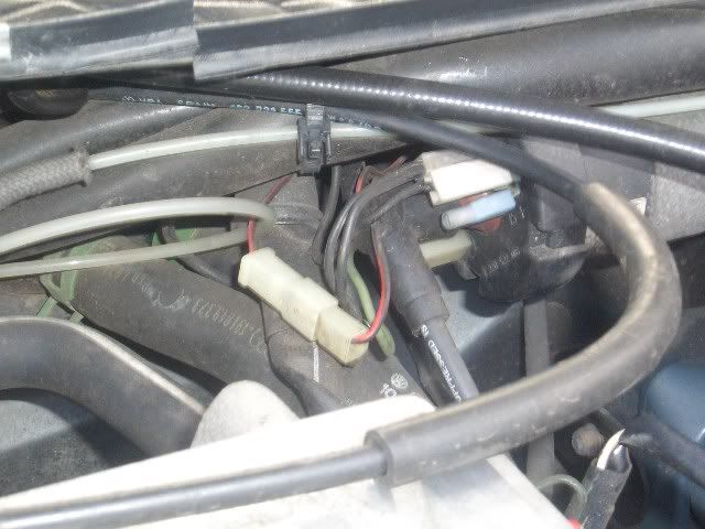

just been to check this red lead thing on my car for setting up the k jet and the only wire there is red and black, is that right?

16v?? Are you trying the set up the CO/Idle?
It is obvious... Its the red (possibly red and black), but it is near the coil
Hang on heres a piccy - Just found it!

I am mate.
thought as much. it's the only thing thats anything like.

whats this wire for and what do you do with it ?? cheers

i'm not sure what it does tbh. it's part of this thread.

it basically turns off the idle stabilisation valve. allows you to set the car up without the isv interferring
