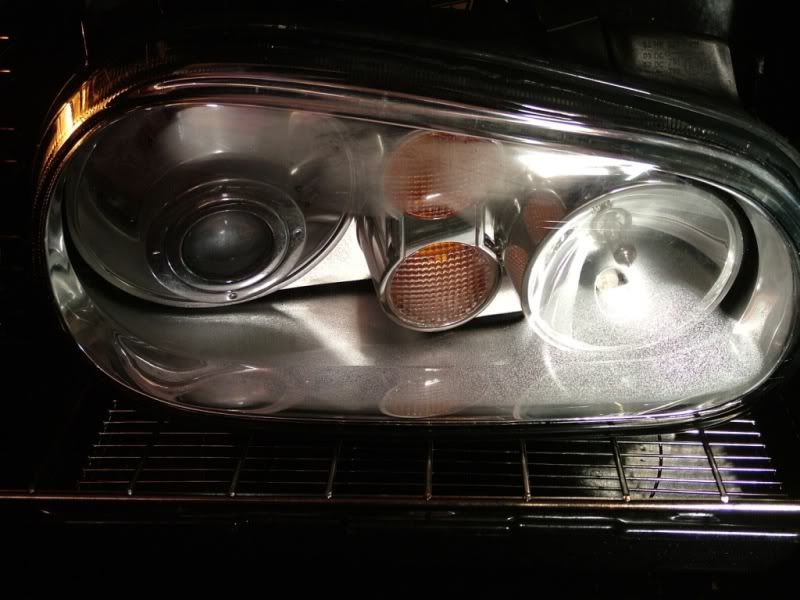

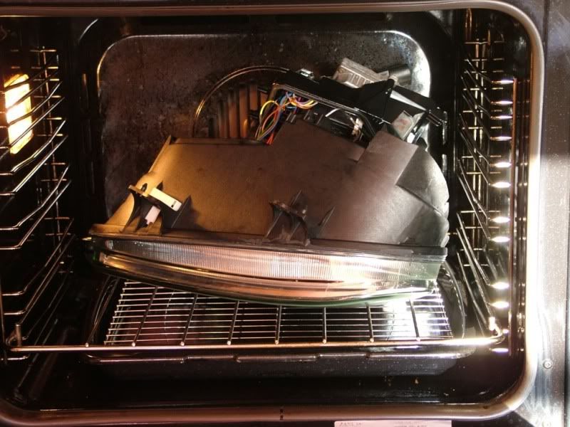

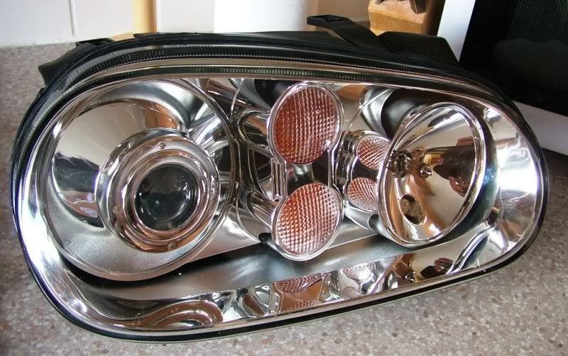

As said silica gel works well or you could try this  :laugh:
end result :afro:
Just don't turn it up too high  :grin:
