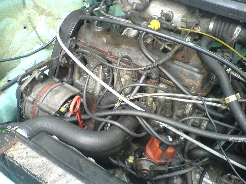

Top section? - Sorry confused, my cambelt cover is is one whole piece as far as I can see..
This is a very old photo but cover is still the same (i know its at the wrong angle..)
Cheers..

The top section is metal, held on by 2 10mm nuts which hold the left side of the rocker cover down aswell and a 5mm allen head nut on the side. Easy peasy man  :smiley:

hehe last night i was tired and so taking it off seemed awkward - did it in 5 mins this morning ;) thnx!
