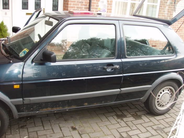

So i went out a bought a £250 1.6 driver 3dr, it had some rust on the doors a dent in the rear 3/4 pannel and smelt like wet dogs!!!! BUT apart from that the shell was really straight

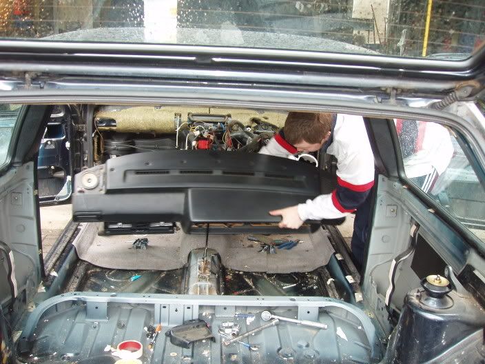

fidly interior plastics out
Dash out

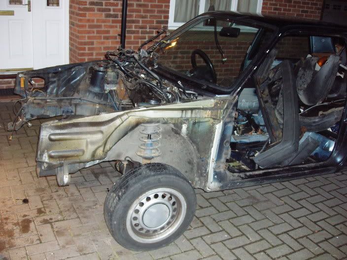

still looks like a car, not for long
engine out time, just took the whole front off its easier and im lazy

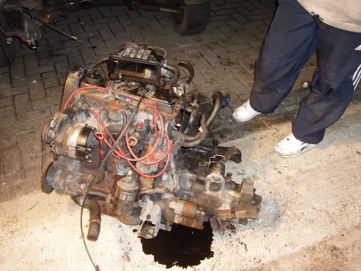

engine out

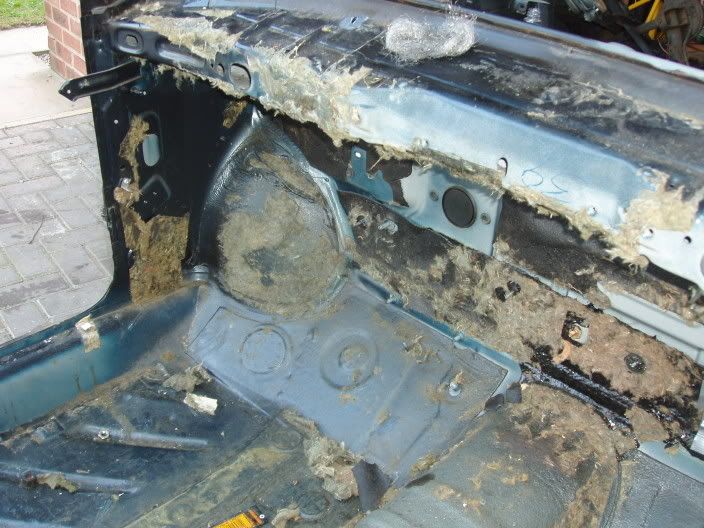

next stage was to remove the nasty sound proofing carpet/mat/inside of dads old slipper that was stuck to the dash, basically involved lots of time with the grinder/wire wheels and petrol
