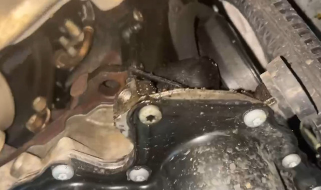

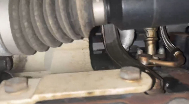

This this help?

Difficult to tell clearly but doesn't look like the same place as mine. Been a while since it happened. The oil stain was close to the joint of sump to block and cam cover at the back of the engine.

Thanks, I will have to go back for a diagnostic then
