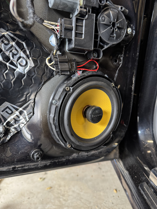

I've nearly completed this now. I ended up replacing the OEM speakers with JL Audio ones when I was at it, got them well siliconed up along with a couple of other weak points in the door and put everything back together.
The carpet ended up drying itself, and I gave it 2 goes with an enzyme odour eater and the offensive smell is no longer.
I've ordered 2 replacement inner door seals which are due to arrive in to my local dealer today. I don't think these were necessary, but given that the metal grip teeth in the original seal were rusted I thought I might as well. Just wondering if anyone else replaced the rear inner seals and what did you use to seal them? Any tips for the install too?
