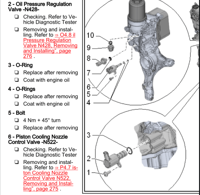

I'm in need of a little help pointing me in the right direction with my Alternator. (GTI VII 2013 Performance Launch model)
Currently its not charging immediately after what I suspect to be a blown seal on the oil pressure regulator valve, which happened due to sudden acceleration — nothing extreme (like 0-60mph) but sudden, thats when the error message came up battery not charging.
Initially I thought it was just the alternator knackered, but on closer inspection I found high pressure oil splatter/spurts on the Alt belt and pulley wheels, which is now pointing me toward the oil pressure valve thats located just below the alternator.

My question is, could the oil have damage the alternator? Or is there slippage on the belt due to oil on the pulleys? Looking at it, it all seems to be running fine, no weird noises; no oil leaks or oil warning lights.
