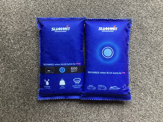

FIRST check the carpets in the front and rear foot wells and the lining under the spare wheel. Mk7s are notorious for leaking water via air vents under the rear wheel arches which ends up in the boot.
If you find no dampness and it continues buy a couple of these and put one in each corner of the front screen when not in use. They absorb all moisture and you recharge on top of a household radiator. Highly recommended.
