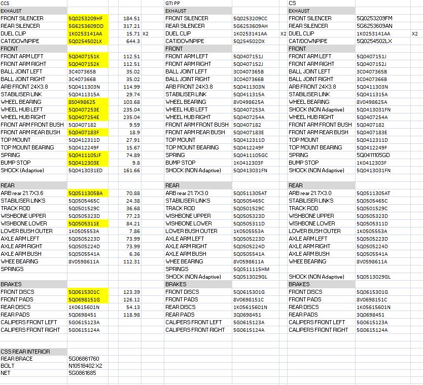

Not sure on the first 2 but for me, I would get Cup 2's or very aggressive summer tyres and CSS rear ARB to start with, would also go for CCS discs and pads (the pads are Ferodo DS but from VW). The front wishbones aren't any different but the rear bush in the front arm are I think, so you can either purchase the arms complete to get a more direct feel or just get the bushes. The bushes do need to be fitted in a specific direction.  (I always prefer handling over power gains)
This is my list from many years ago when I was on this forum with my first mk7, price rises have taken place so the prices are not accurate but would give you an idea of CSS parts compared to PP.
