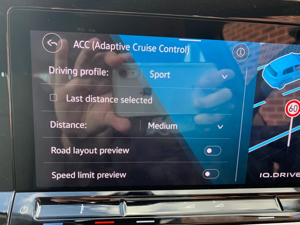

You need to go in to the Assist menu and then click on the 'Car in front' icon to access the ACC menu and then turn off 'road layout preview' and 'speed limit preview'. These two (badly worded settings) cause ACC to follow speed limits and slow down for roundabouts etc. Switch them off and everything is back to normal!
