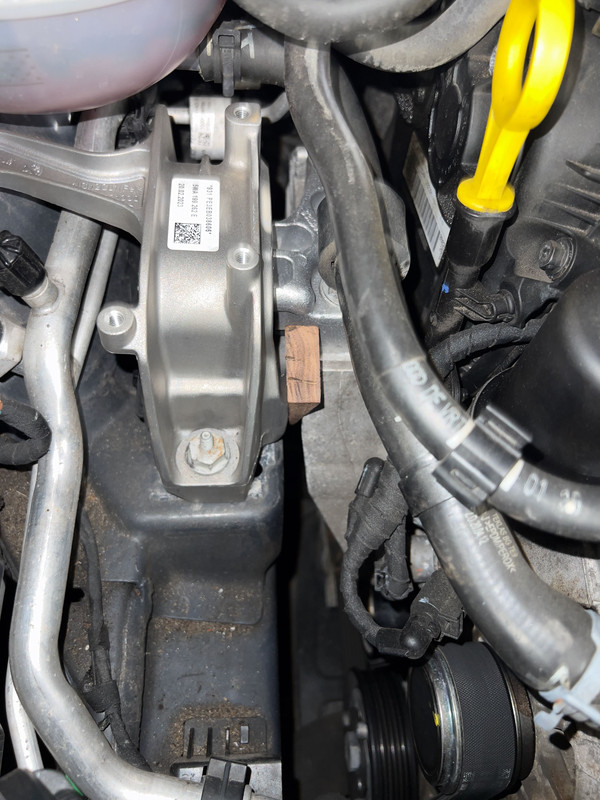

It's developed a creak on the front right which is driving me and my mechanic up the wall.
The creak is on any undulating surface and also when driving off from a halt. It's not different in the cold/hot or dry/wet.
So far we know its NOT (because these have all been replaced with new parts):
The shock; spring; top mount; top mount bearing; lower control arm; ball joint; anti roll bar bushes / endlinks.
When we hammered a wooden wedge into the following space next to the driver's side engine mount, the noise disappeared.
Shockingly, replacing the engine mount for a new one made no difference!!!!
What next ?!
