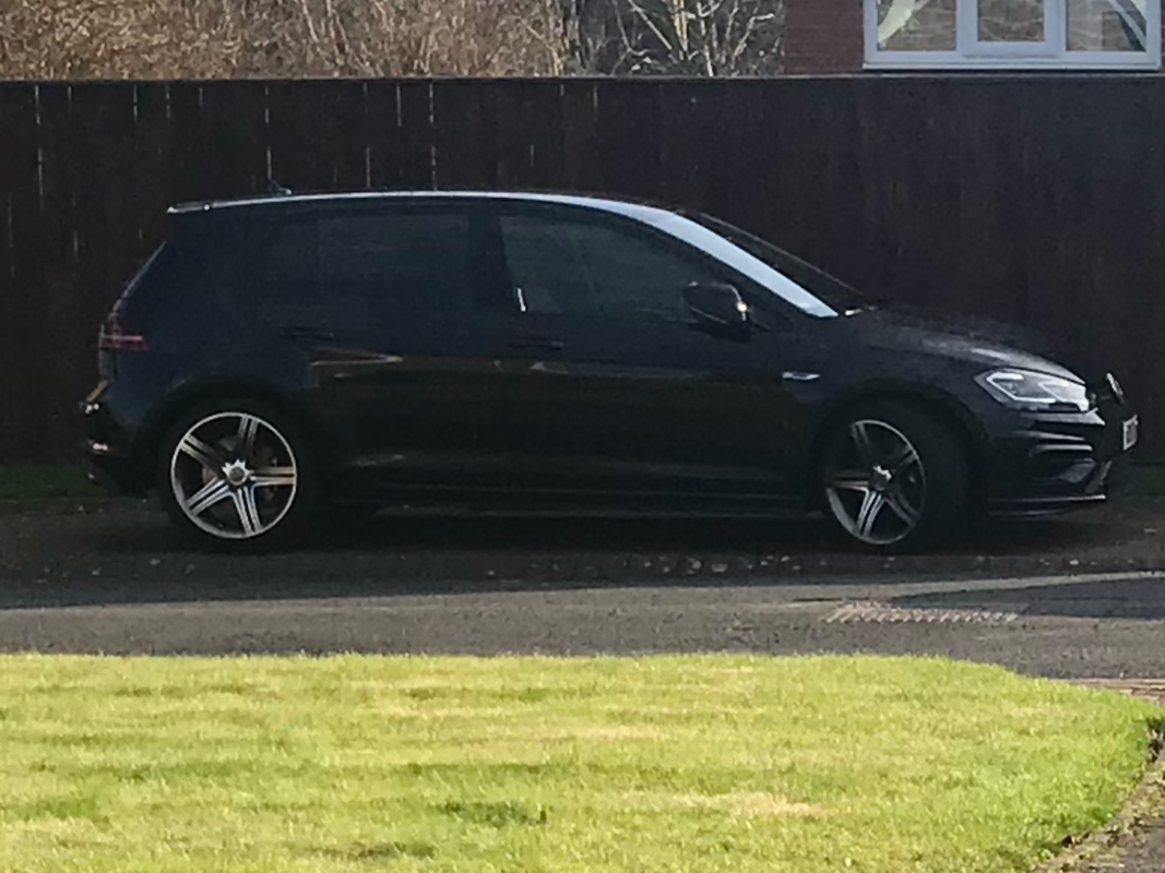

My Winter set up on 2019 R;
AC Hockenhein 8.5” wide 18” et45 wheels x 5 very strong and lightweight at 9.5kg.
Continental Wintercontact TS850P 235:40:18
