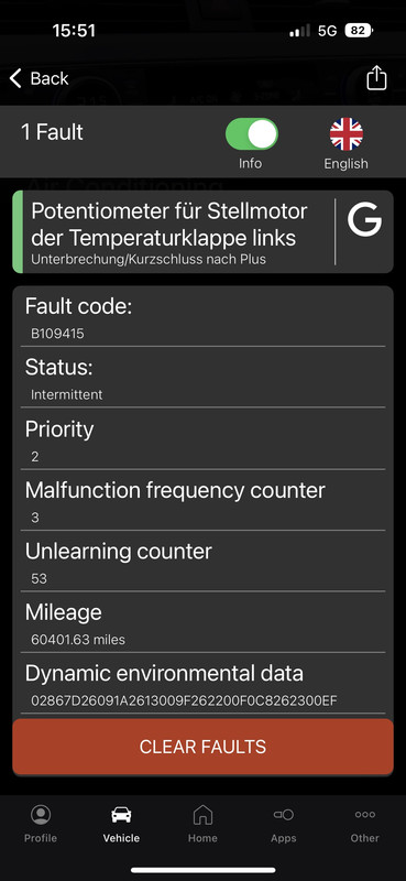

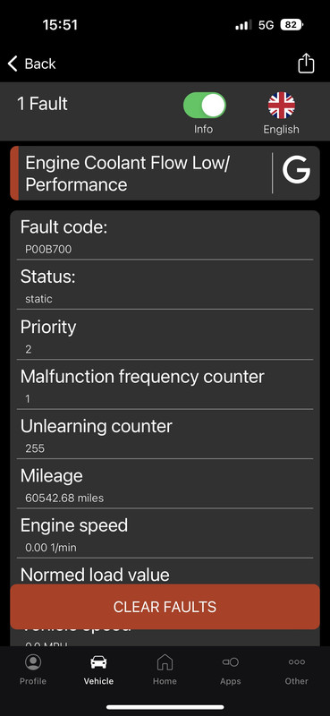

Out of interest, these two error codes appear quite regularly when I do an OBD11 scan - another clue pointing towards the water pump/thermostat being faulty??
Offline joe6
  • Posts: 955
Re: Overheating or not??
« Reply #16 on: 26 November 2022, 09:24 »
The low flow fault suggest water pump problem.
