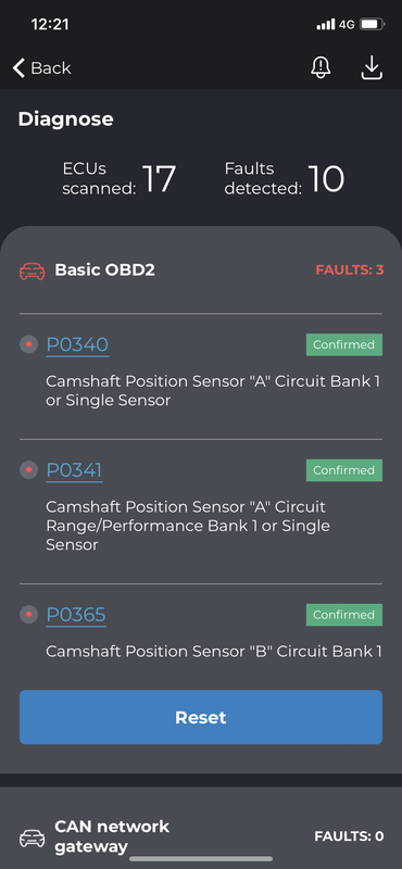

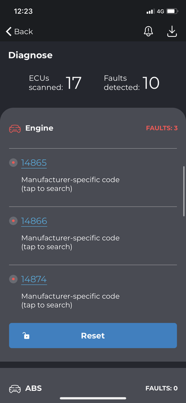

Noticed that it’s a bit lumpy at idle from cold after a couple minutes driving and will cut out occasionally as it comes to a stop when the clutch has been depressed, this happens quite regularly and will go away when the engine gets warm. Was reading up that the MK7’s are a bit lumpy from cold but thought I’d try and diagnose it anyway using a Carista OBD plug in. It’s picked up some camshaft position sensor faults and now I’m starting to panic slowly that there could be something sinister lurking. Anyone had similar experiences with these early MK7’s ?

The symptoms you describe and fault code are cam sensor issues. The cam sensor helps with injector fuel timing and spark timing hence the poor running from cold. Can lead to overfuelling and eventually could affect the cat. Would get it sorted quite quickly.
