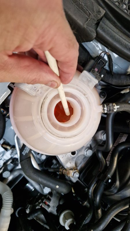

Its to the right of the prongs.
Slightly different expansion tank but you get the idea.

I can't see anything

Have you just had a feel around or have you siphoned the coolant out??
I thought mine had been taken out because I couldn't feel or see it until I siphoned the coolant out.
It’s really tucked away. Well worth the piece of mind to be 100% it’s sorted either way.

Yeah going to go for it later, its just working out how to Siphan off the fluid
I bought one from Amazon - like a big Turkey baster / massive Hypodermic  (I nearly bought an actual baster before I saw the one I bought)
