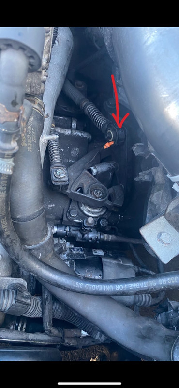

jonesltd

12 August 2022, 08:36 »
If you cant find it......Grind it
madstaff
Posts: 709
Re: What’s this?
12 August 2022, 08:55 »
Gearchange linkage, looks to be missing a clip, hence the small yellow cable tie.
Watts
Forum addict
Posts: 4,909
Re: What’s this?
12 August 2022, 09:09 »
Quote from: madstaff on 12 August 2022, 08:55
100% this. Clearly the linkage has been apart at some point and the clip lost or broken hence the makeshift solution.
