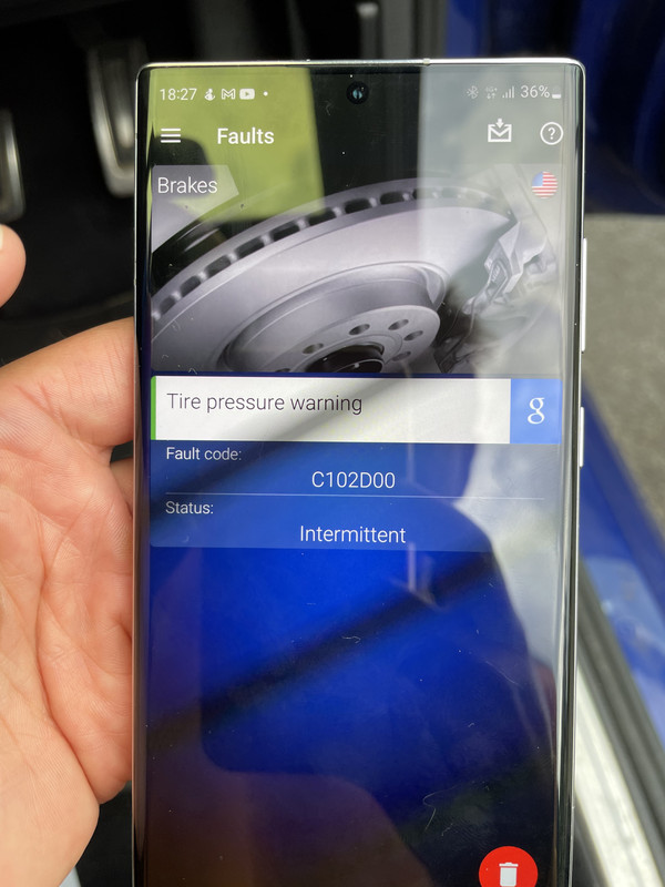

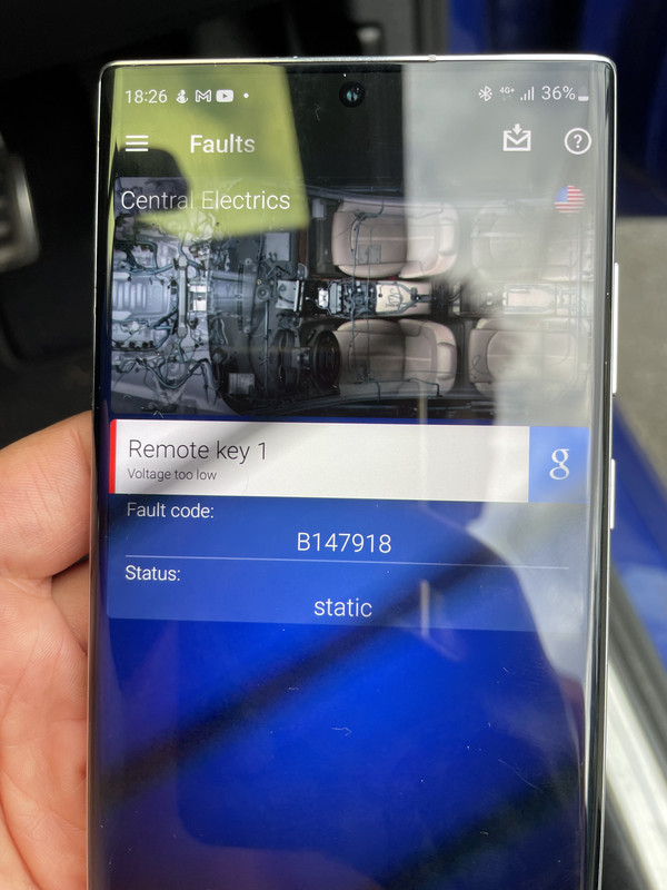

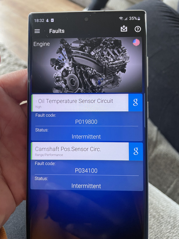

So I  FINALLY got my ODBeleven and haven’t activated the pro subscription but have scanned the car and it’s come up with this:
Do I need to activate the subscription to dig deeper into the car? If not then what is this subscription thing actually for?

As far as I’m aware, you don’t need credits, or a subscription, for diagnostics.
It’s already showing your fault codes, clear them and see if they come back.
The credits are for people who enjoy doing fancy programming stuff,  like making your dash fluorescent yellow- stuff like that.

All the first faults are green which means not normally a problem, and the ECU’s just got info they didn’t expect at the time, the only one to worry about is the low voltage on the key as you may not be able to unlock the car soon,
Free- scan and clear dtc
Credits-apps add/remove mods/features and also do service items (credits can be either free (6 a day watching ads) or paid)
Pro- all of the above but let’s you go into the modules and change long coding/adaptions, long coding is like on off switches, adaptions is more like option a, b, c (which is a paid yearly subscription)
