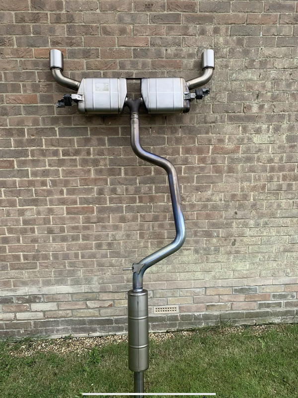

I don’t think the OEM Akrapovic exhaust is a back box delete. See photo attached of the OEM TCR Akra exhaust, it still comes with the rear muffler. Hence why the sound difference is minimal when compared to the standard exhaust, mechanically are very similar.
Thank you so much for pointing me out Power Valve, I’ll 100% give them a call tomorrow.
I was so close to get a Clubsport 40 and then decided for the TCR…I was better going for the CS40, being pre GPF would sound dramatically better?

Ah I must be thinking of a different car regarding the no back box.
