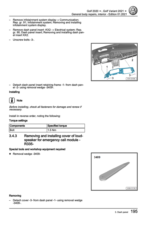

I have a crackling/popping speaker in my Golf. It has been in to be checked and they have informed me it is a faulty speaker in the dash. I have checked the Volkswizard youtube video and the problem he describes at 11mins 8secs is exactly what I have, however mine does not show any fault or warning on the dash.
I have explained all this to the Service Advisor at VW and he insists it is faulty and needs replacing.
My concern is they remove the whole dash to replace the speaker (I have no confidence in their ability to put it back together properly). They have told me they dont need to do this but I am not sure, and if I am honest I don't believe him (as you can tell I don't have good experiences of this dealer).
Does anyone have any experience of speaker removal on the golf?

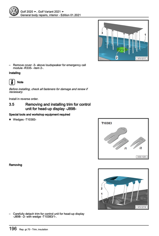

This?

The popping sound is caused by the sos unit as far as I know... Not the speaker.
I agree 100% especially as at the same time the globe and GPS icon disappears from the unit.
And yes, that does appear to be the correct diagram of the speaker.
