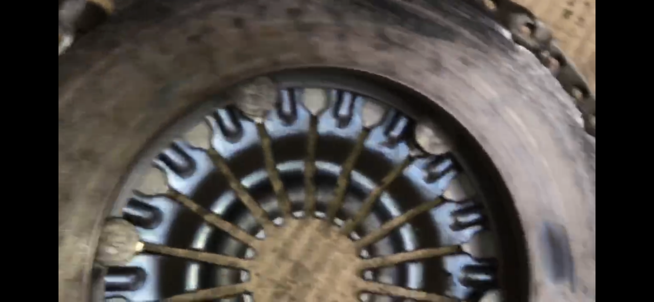

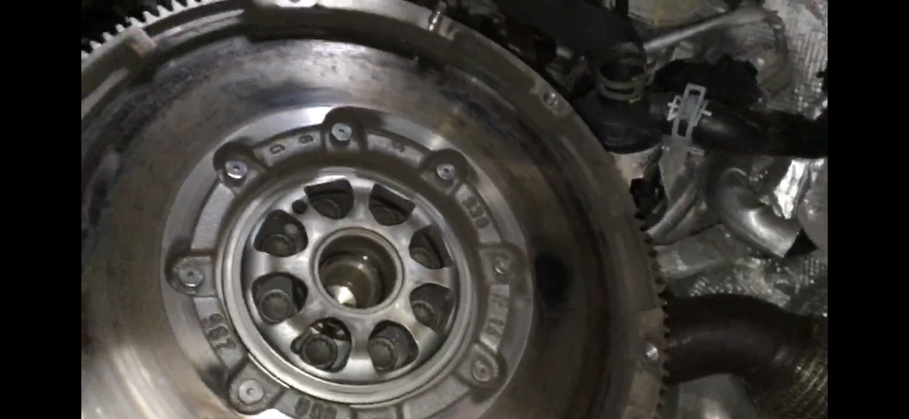

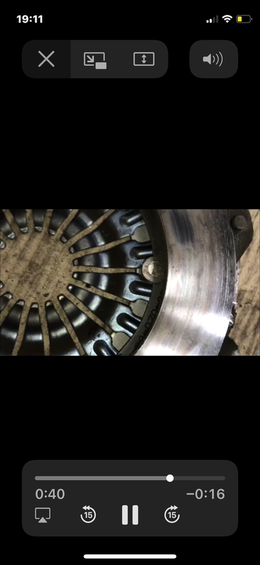

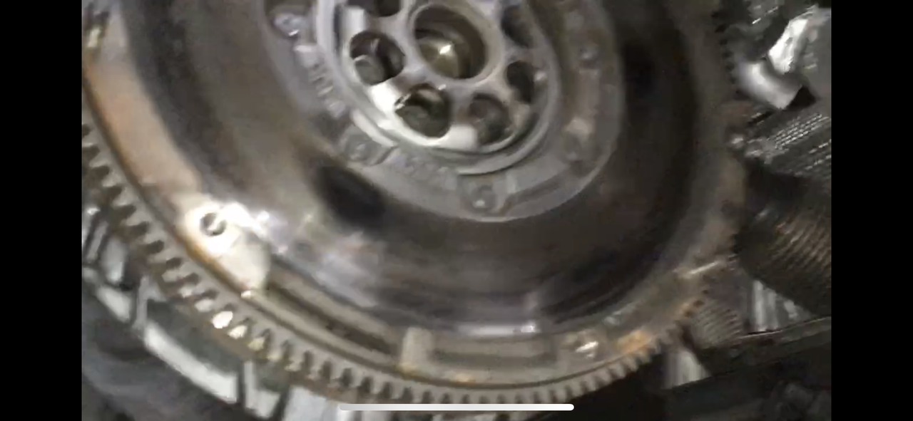

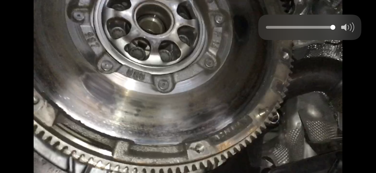

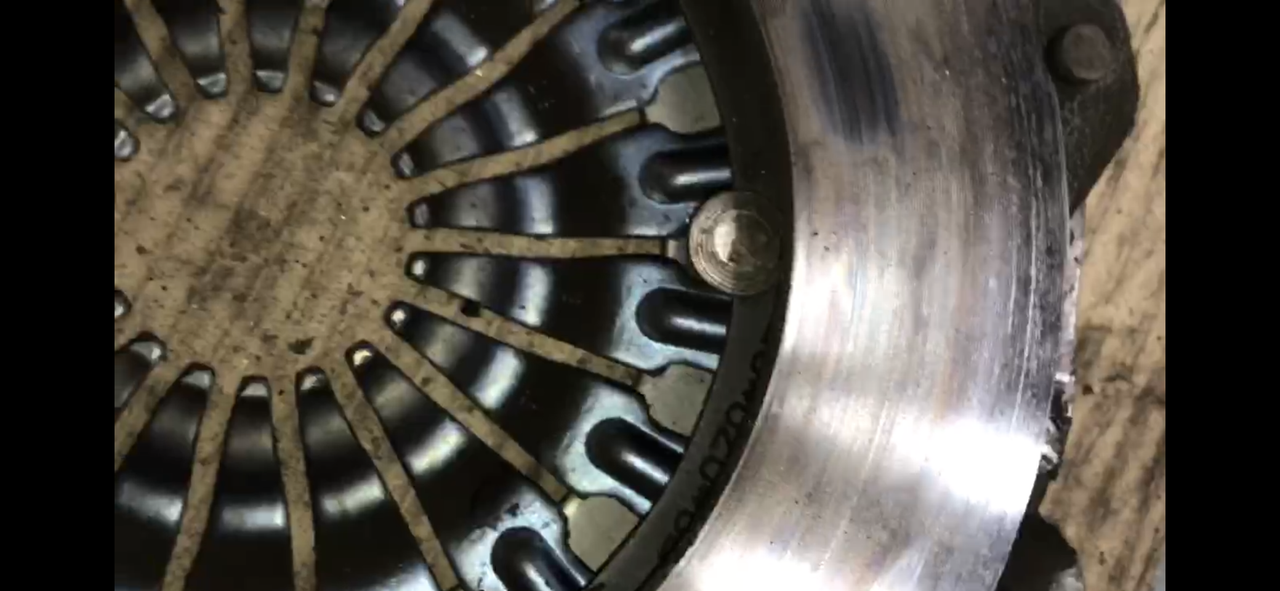

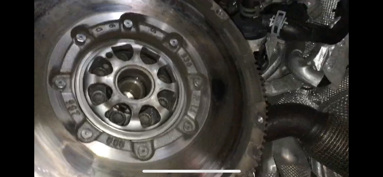

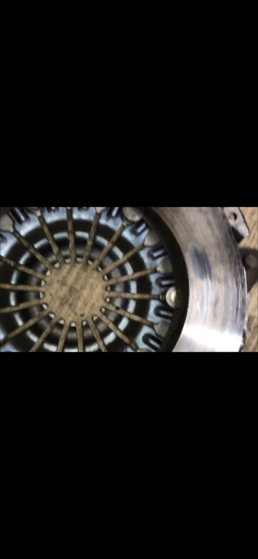

« Reply #26 on: 28 June 2021, 19:14 »
Quick update I need a flywheel too , not having much luck, here some pics
