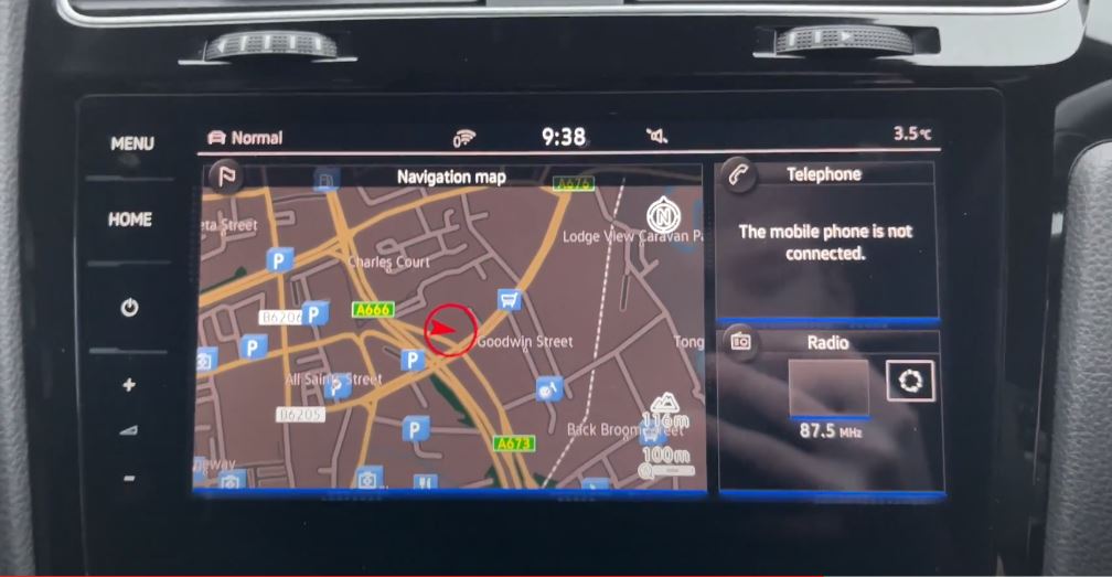

is this split screen view only available on discovery nav pro ??
GTI 7.5 Performance 5dr DSG Tornado Red - completely standard spec as - it comes out of the tin as they say
Offline Sootchucker
  • Posts: 2,349
Re: infotainment view
« Reply #1 on: 09 December 2020, 12:38 »
Yes

Has anybody on here upgraded from the 8 inch screen to the 9.2 inch screen shown above?
Looking into it,seems you need the MIB 2.5 infotainment unit for the larger screen to work.
Anybody know how to identify which infotainment unit is fitted to your car without removing the unit?
Also,if you buy a used unit you have to deal with ‘component protection’ and have a lot of programming done,with a chance of losing CarPlay and voice control,if you already have them.
I priced up a new 9.2 inch screen from E-acca,just short of £1100 and that’s just the screen.
I think you would still need to programme a brand new screen to your car,even if you had the correct MIB unit.
I do like the look of the larger screen but is it worth the expense/effort for what you would gain over the 8 inch screen?-which I currently have.

You'd get gesture control (and you'd switch it off almost immediately), a nicer hi res screen that's a lot bigger, finger prints all over it (it really shows up finger prints), a faster more responsive touch screen and maybe the ability to have maps on both screens at once.
I say maybe because depending on who you get to install it, you might get the aid integration, you might not. Voice control might not work too.
And yes it needs the different "brains" in the glove box to drive it.
If you have the standard unit from the mk7.5, I'd not bother... And I have nav Pro.
