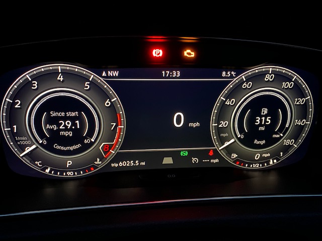

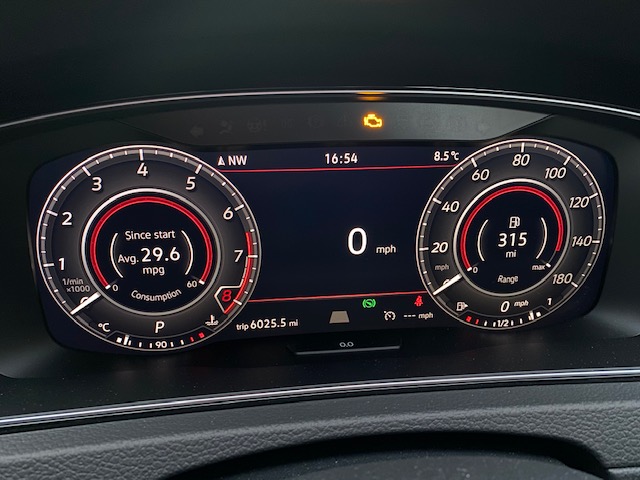

Folks - thought I would be clever and have a play with carista by activating colours and tweaking cluster theme etc - however, sure I did not permanently change anything (I actually ended up reverting all colour theme option/numbers back to "None "and reverted cluster theme back to original number/default setting of 4 - i am sure it was set to 4 as I took a photo before changing anything). However, as in the below before and after somehow I seem to have lost the red inner highlight and replaced it with white . Can any carista/obd 11 users advise me what the default aid settings are or is there a way to revert the aid back to factory setting?
Thanks
Before
After

So dug out some mods I did before I enabled background lighting to change the colour scheme, and found that changing vehicle variant in long coding in the dash module to 2 or 3 brings up the red colour (2 door and 4 door GTi), not sure where you got 4 from if indeed this is what charista uses to change the colour

thanks - through a bit of trial and error it is now sorted
