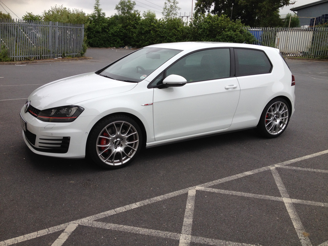

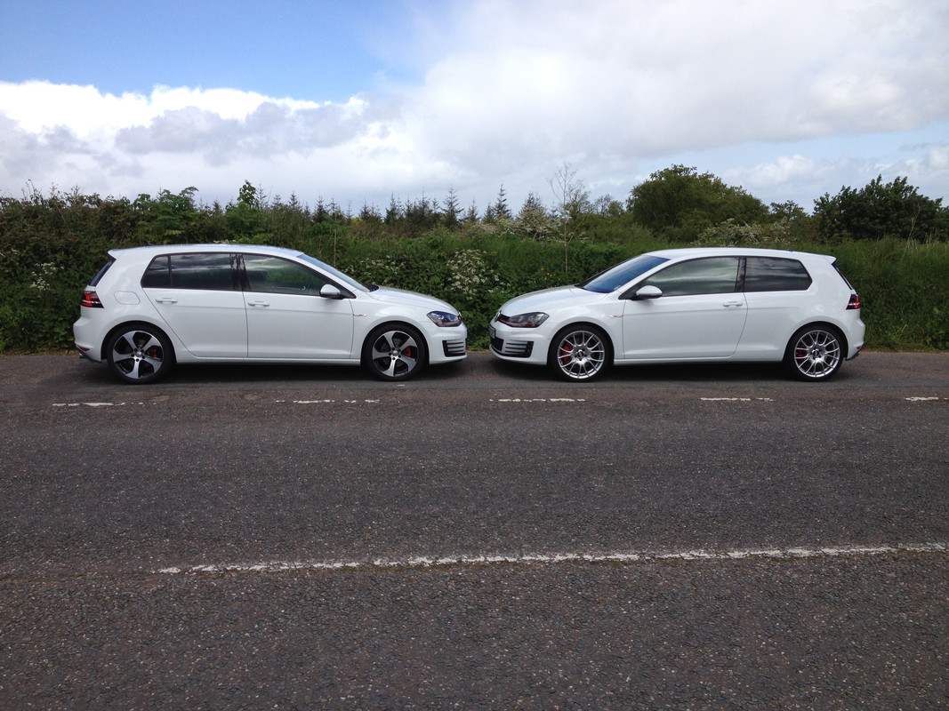

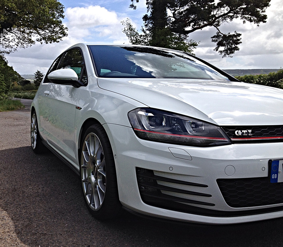

Here’s my GTI from 2013/4 when I briefly ran the BBS CK’s I had on my mk6 GTI’s on my Mk7.
These were 8x19 ET44 which fitted quite flush on the mk6 but allowed a bit of elbow room with the mk7 which has slightly bigger arches at the front and much bigger at the rear. Bear in mind the mk6 is basically a Mk5.
I’ve also run 8” wide and ET41 on a mk7 which fit fine at the front. ET35 will be very very tight for clearance if using 235 tyres.
The rears are no problem, ET35 easily swallowed and will sit nice and flush.
I’d be VERY wary of using ET35 on track on the fronts. A set of different track wheels would be my choice. Or at least a pair for the fronts with a slightly higher offset.
If you want some more shots of how the CK’s look on the mk7 I have a few more.
To be honest I think they suited the mk6 far better (they were the perfect wheel for the mk6).
In your shoes I’d be getting 18” BORBET FF1 in ET45 front and ET35 rear with 225/40/18 tyres.
