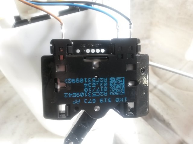

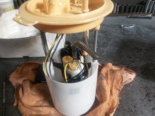

If its still under warranty let VW sort it out.
I would imagine its probably the fuel sender unit in the tank playing up, but the sender unit (bottom pic) can be changed on its own without having to buy the whole fuel delivery unit (top pic) as it just unclips.(Pics are of a MK6 but essentially the same)

I think the one i replaced had similar symptoms to you, relatively straightforward to do providing the tank is not full of fuel.
