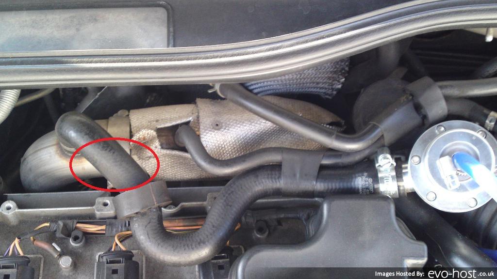

Anyone know what this pipe is called?
« on: 23 March 2015, 12:39 »
Do forgive me if it's a dumb question but I'm after the pipe circled in red but have no idea what it'scalled lol. Any ideas?
Thanks in advance
Offline MoMartin
  • Posts: 408
Re: Anyone know what this pipe is called?
« Reply #1 on: 23 March 2015, 17:17 »
i'm not sure about the name, but it connects the charge pipe to the diverter valve, so i'd try searching on google for that.

Apologies slightly wrong page, go back a page from that and you can see all the silicone hoses they offer.

After going to VW they told me they can only sell me the pipe as part of a kit which comes to £131!! I ended up finding one in the scrappy off of a Seat Leon for £6. For anyone with the same problem, the part number for future reference is: 8L0 145 691 F & it's called a turbo pressure hose
